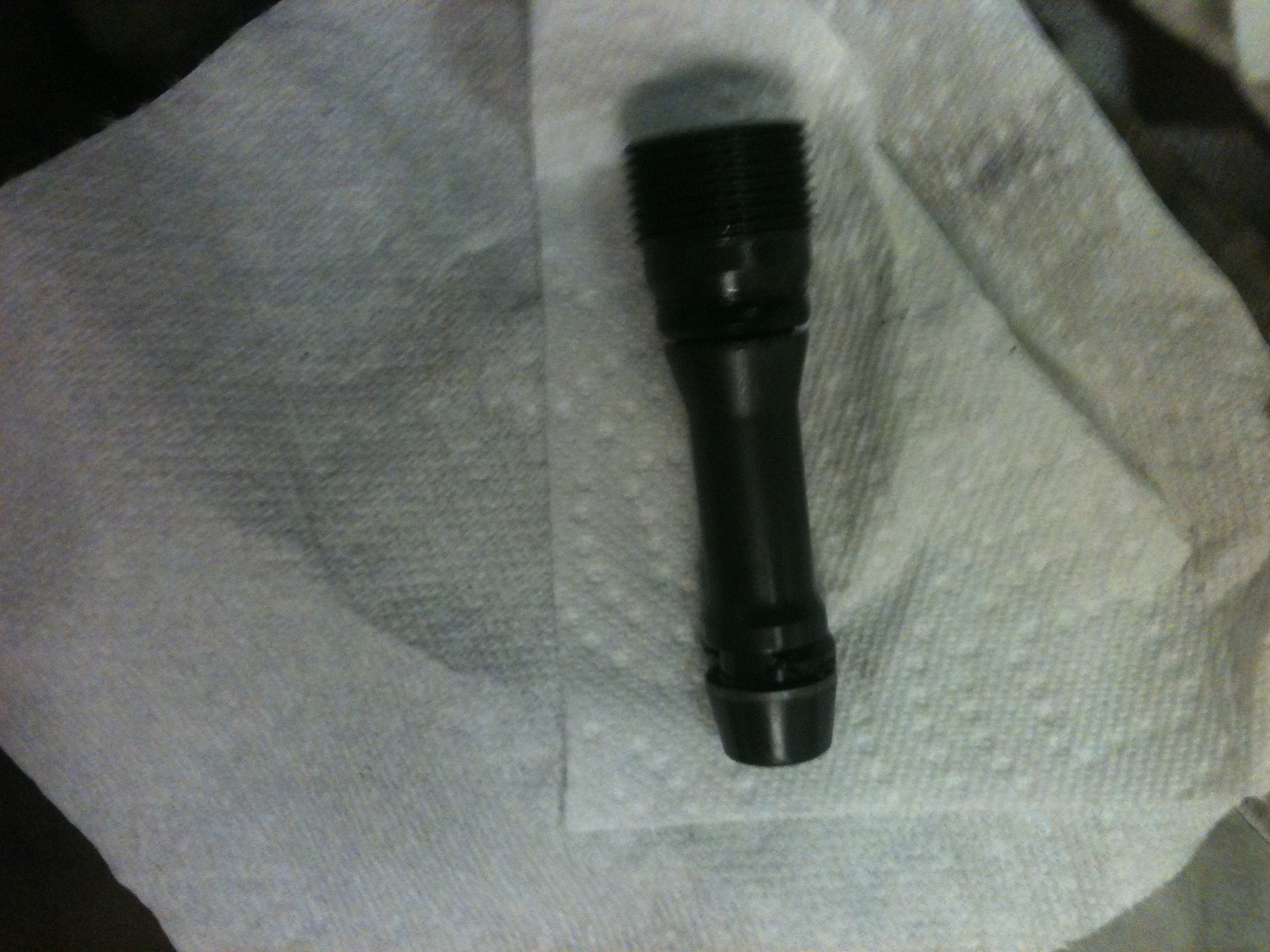

This pick is one I had this weekend....Once truck was fully up to temp, would not restart for 2-3 minutes. For the next 5 or so, a long crank would start her. Truck could make 3500 psi, but the leak was so bad, a twenty gallon capacity compressor had to continuously run to stay over 90.
