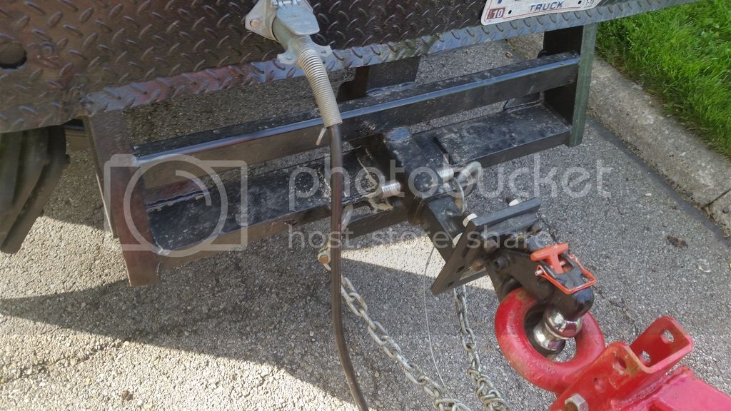

Could you get me a pic of how your hitch is set up on that flat bed? On my 450 there isn't any receiver just a 2 inch ball put through c channel and I am wanting to build something to accept a drop/raise hitch.

I've never seen an aftermarket hitch for a non C&C truck that bolts to the side of the frame. The next one that goes on will be getting a few gussets welded to it.
That hitch was a class V hitch. Wasn't a POS by any means

We had that problem on the red truck we just stripped. It's a pos hitch design! Bolted on the bottom of the frame, as opposed to the sides, too light of steel for the side plates, and general dumb@ssery.
You can't do that with most pickups because of the rear leaf spring hanger. A few extra gussets and a little extra plate of the sides wouldn't hurt for the next hitch.
