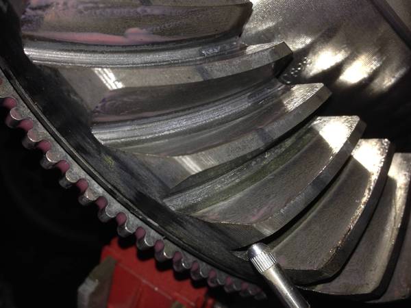

Checked the backlash and the pattern of the rear ring and pinion. Replaced the Redline Heavy Shockproof gear oil for Royal Purple. Not bad for 7 years of terror on this rear end. I only measured .004" of wear on the R&P (Still well within spec) and the oil looked real good but very aireated.
