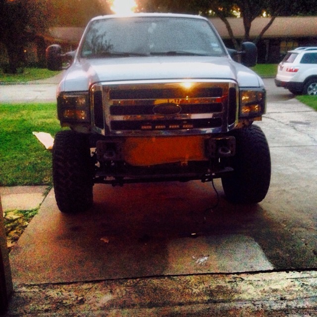

Took the bumper off
Sand blasted all the supports
Wire wheeled the frame
Primed
Painted with john deer blitz black

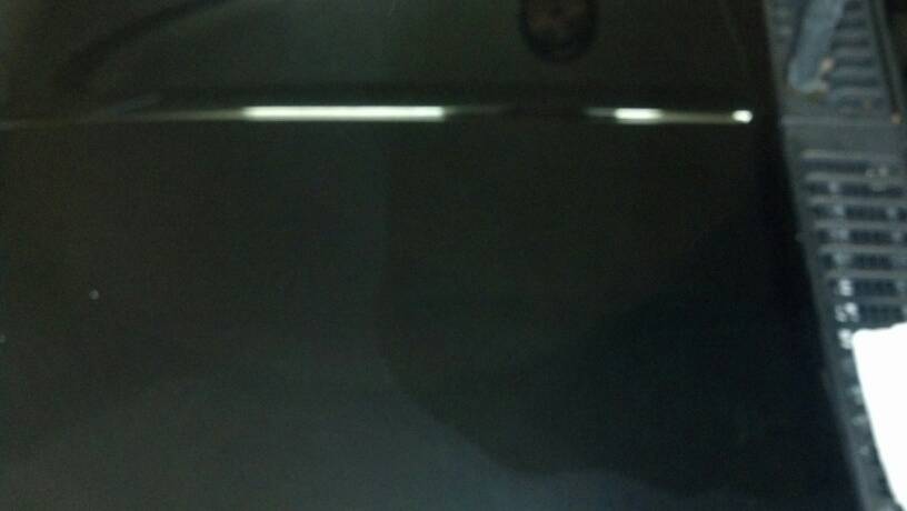

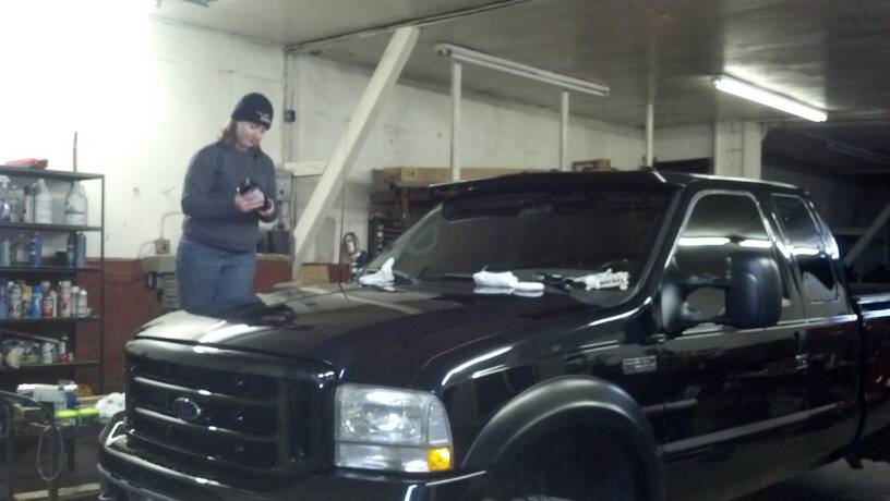

Long night ahead. Compound and polish and wax whole truck. ( Courtney standing on the tire putting in work on the hood Lol )

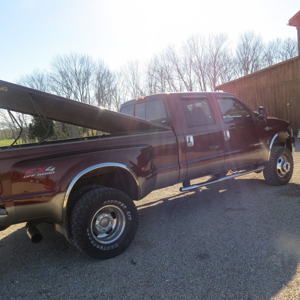

05 king ranch
new 6.0 owner, hopefully this is it for awhile
heads: magnaflux, deck, pressure check, touched up the valves
arp studs
upgraded hpop orings and seals
03 turbo with billet upgrades
heat wrapped up pipes and down pipe
ficm repaired
replaced 3 injectors then modified by ROSEWOOD into 175/75
basic fuel system mods (flushed, cleaned and repaired fuel pump)
egr delete
new oil cooler
coolant filter
removed catalytic converter from banks 4" exhaust system
SCT livewire ts 5015 w/egt probe
Innovative tow/jake, street and extreme x tunes
ROYAL PURPLE xpr 10w40 oil
3" lift

I spent $8300 on the dually I got listed above, there was a lot more stuff done then whats listed I just listed the stuff that mainly done to motor, the front brakes were locked up ,new brake lines , remote start had to be taken out, and the guy that owned this truck never done a bit of pulling or anything. Good thing I got a good buy on it.

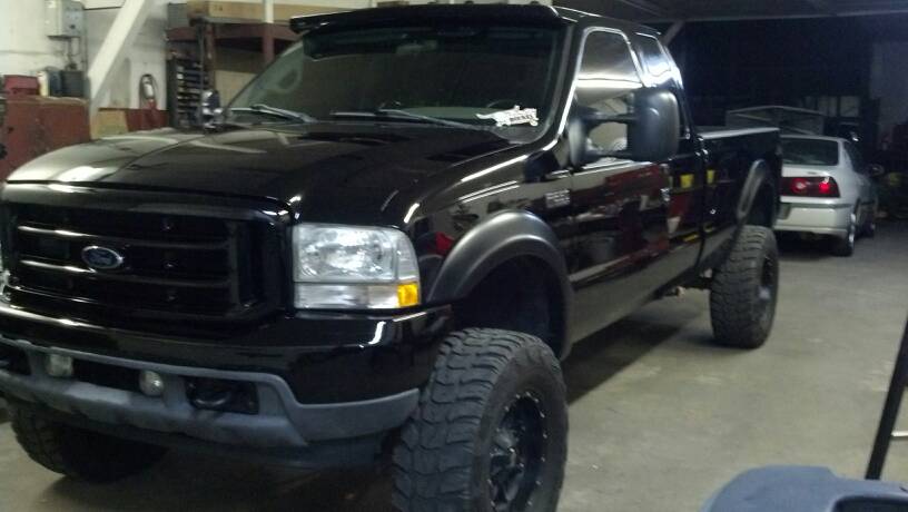

That's gonna look a lot better buddy!
We finished up at like 11 not to bad considering we took a break for dinner
