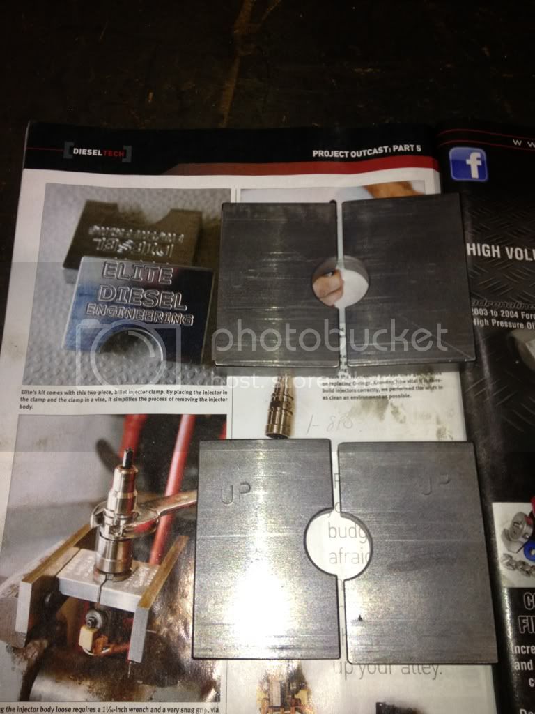

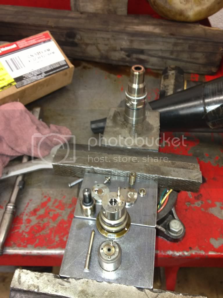

Anyone swapped nozzles yourself? What did you use to unscrew them? Just need to pull them apart and put new nozzles on and out it back together. Putting in new o rings too.
In swapping out the injectors, what is the job worth to you? How much would you pay before you would just do it yourself? How difficult is the job?
Its easy as can be man.
You don't even have to take the fuel plates and check balls apart...when you GENTLY slide the body off of the injector, the nozzle and all components below it will stay in place.
Just GENTLY lift the nozzle and replace with your new one, then slide the body back over and hand tighten then torque.
The nozzle has dowels in it for alignment.
