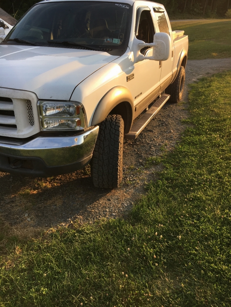

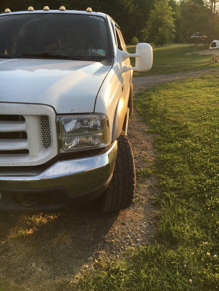

Got some new tires on the old girl. 305/70 r16 Toyo open country extreme at2. On 16x10-24 wheels. I absolutely love this look, just wish I could lose the fender flares. And I know it's extremely dirty but I haven't gotten around to polishing the turd yet.

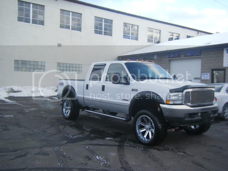

So found this ad on Craigslist for a 250 and the truck running 37" tires on a 3in lift? Says he has 3in spacers on it for clearance. I love the look of the truck. I would like to do something with mine like that but I don't want the 3in spacers. What width wheel and bs would one need to run to get something like this?
