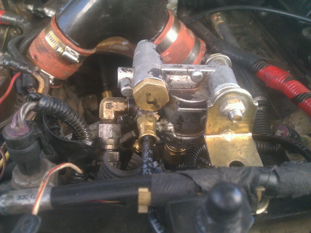

Mounted mine off the HPOP res stud It then allows the return to go right down the valley and out and the two front fuel line output from the heads to make a short curve up and into the reg.
