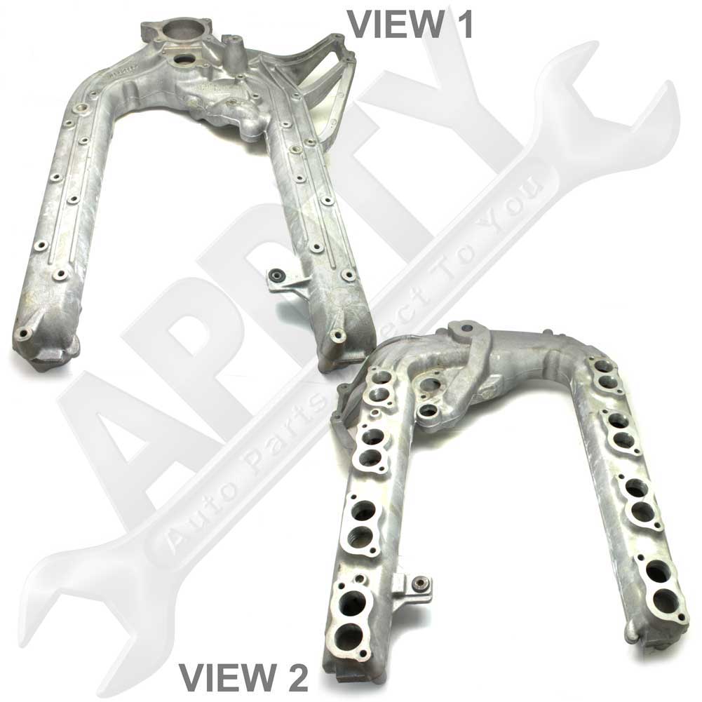

Ok this is my first time dealin with the intake manifold so where exactly is the O'ring I need to check. Sry I know it's a newb question but ya gotta start somewhere.
On the bottom view of the intake, it's the hole directly underneath where the intake elbow is on the top side. On the bottom view you can see the coolant passage in the intake from the EGR cooler to where this big o-ring PowerStrokeEnginuities mentioned is. It just gets sandwiched between the intake and front cover.
