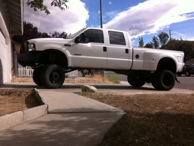

I did that too
10" lift on 32" tires gangster as sh!t

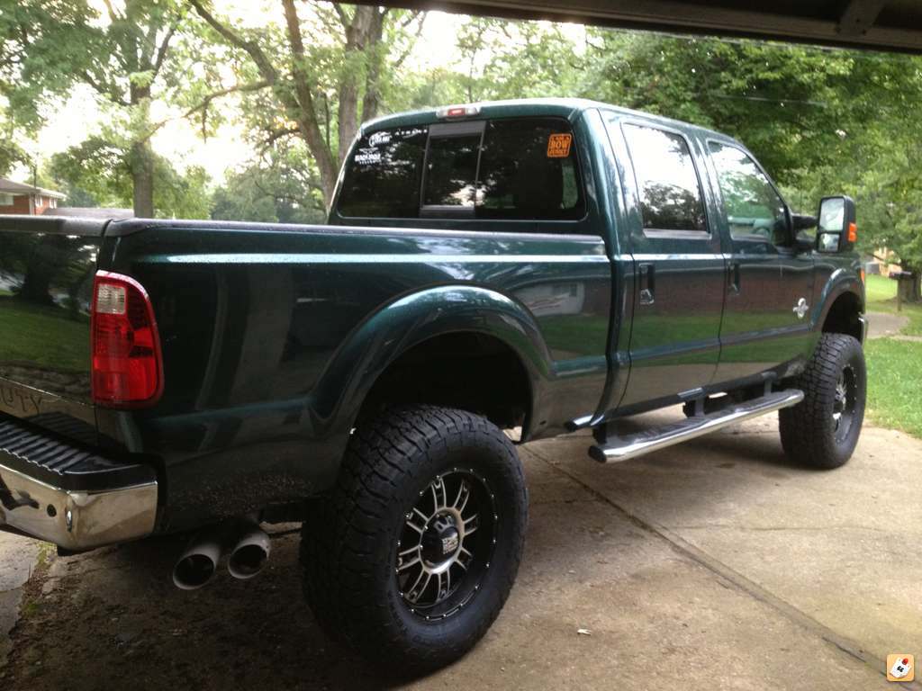

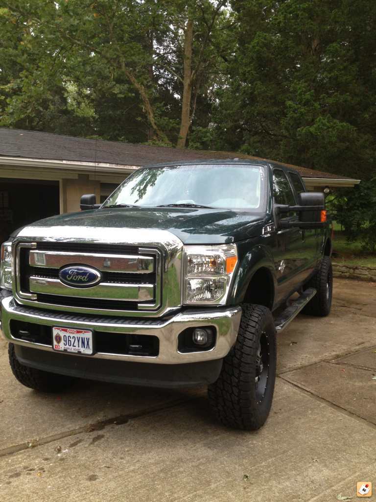

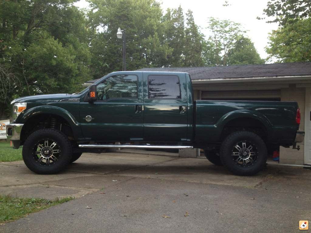

I ended up running a 1/4" spacer on the front and I clear perfectly! I wasn't far before from clearing but this 1/4" have me plenty of room! Thanks for all the input fellas.
VanoFord
Nov 9, 2012
770
Sugarland, Tx
if all you used was a 1/4" spacer, i would get a set of rims that gives you that 1/4" in backspace, something w/ the same width you have now but like a +0 offset. truck looks mean w/ that stance though.
