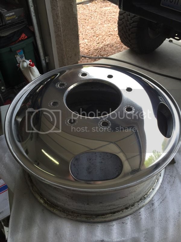

Got my wheel all finished Sunday. Took me an hour or so and alot of elbow grease sanding and polishing. But for $60 it was so worth it. Just need to clear it now to dull the finish out a little to match the rest of my wheels. You can see in the first pic how badly the installer messed that wheel up. The scratch all the way around the rim when they were removing or installing a tire.
Before
After.

Just happened upon your thread. I need to do all 4 of my rims like this. Would love to know the details of your sanding/polishing process and what clear you go with.
My rim was pretty rough. I bought it on ebay for $40 where new are $399. The installers had gouged the face of it around the entire rim.
I used an over cleaner to strip the clear and then polish according. I found a few write up and youtube videos suggesting this and it looks to work great. Here is one of the write ups I had found when searching.
http://www.924.org/techsection/wheel_refinishing.htm
I had to sand with 240, 320 and up on alot of areas to remove some of the damage. On those areas I worked my way up, wetsanding the entire rim with 600, 800, and 1000 and 2000 grit sandpapers. I then polished with a mothers aluminum compound toachieve the mirror finish it should have had..
I then cleared with a clear mad for wheels by rustoleum called High performance wheel paint. Had good reviews for a durable finish.
