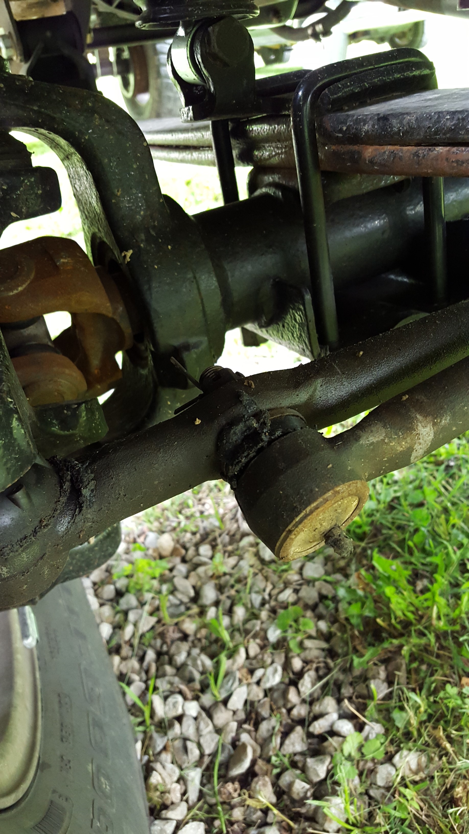

The right outer TRE (Moog DS1071) came with dust boot/bushing to address the roll. So far so good, it's much better. Here's a pic.

What Moog part # did that bushing come with? I just put all new Moog parts on. I don't remember that bushing though.

I bought these http://www.jcroffroad.com/product/PLYBSH.html and have one in the same place, where the drag link attaches to the DS1071 tie rod. This combo seems to be pretty effective so far, I hope it is durable and lasts, too. I still want to replace the drag link once I save up the cash.

I think I know why I'm confused. Lol.
My DS1071 came with both a boot and a bushing, so I assumed the bushing went between the DS1068 drag link and DS1071 Tie Rod. See my attachment for the way I have it installed. :doh:
