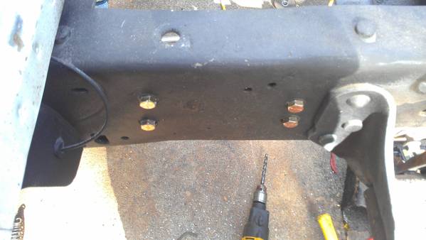

Got the frame welded back together. I cut 11" out of the piece I removed cut the top off 1/2" and bolted it into the splice area with grade 8 bolts. I think the diagonal cuts make the frame stronger, but they were very difficult to get lined up even with the trouble I went through to insure the marks were perfect. It also made welding it back together a little harder, I was having issues with undercut on the vertical diagonal angle on the sides, especially the inside, it was really hard to weld the inside back together. It came out great I think, couldn't really even tell it was ever cut.

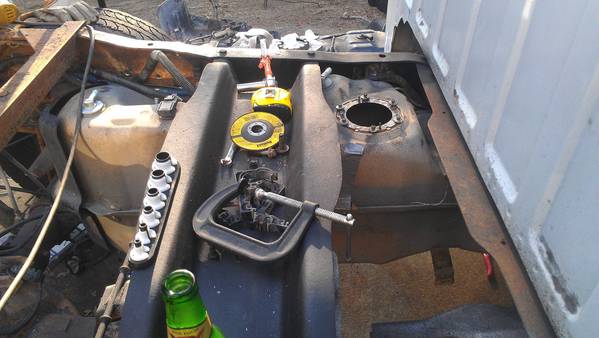

Thanks man, it's a lot of work, but you of all people know that already. Did you just bend your fuel lines back towards the tank or did you cut them? I had to replace the brake line, it was rusted up pretty bad around the fuel tank area, evidently that's a widespread ford problem. Learning double flares was frustrating but I left myself plenty of slack for the learning curve. The f150 tank fits perfectly, thank god, but the lines don't reach back properly.
DEECEE
Feb 26, 2013
103
Put a big fuel cell in where the spare tire goes
The f150 tank fits perfectly so I'm using it after I get everything adapted. A buddy of mine gave me a stainless steel transfer tank that will fit on the passenger side under the bed or in the bed, but with the smaller short bed I'd rather keep as much space as I can.
