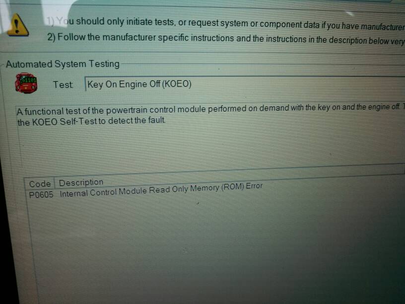

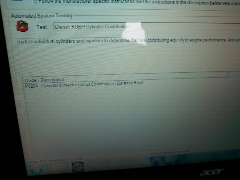

Well I've got a issue with the glow plug relay I think. Keeps blowing the fuse intermittently and has a new fuel pump. Does not do it after its started and warmed up and on cold starts. Here are a few pictures of problems I found while doing tests

what do these screenshots have to do with GP relay issue?

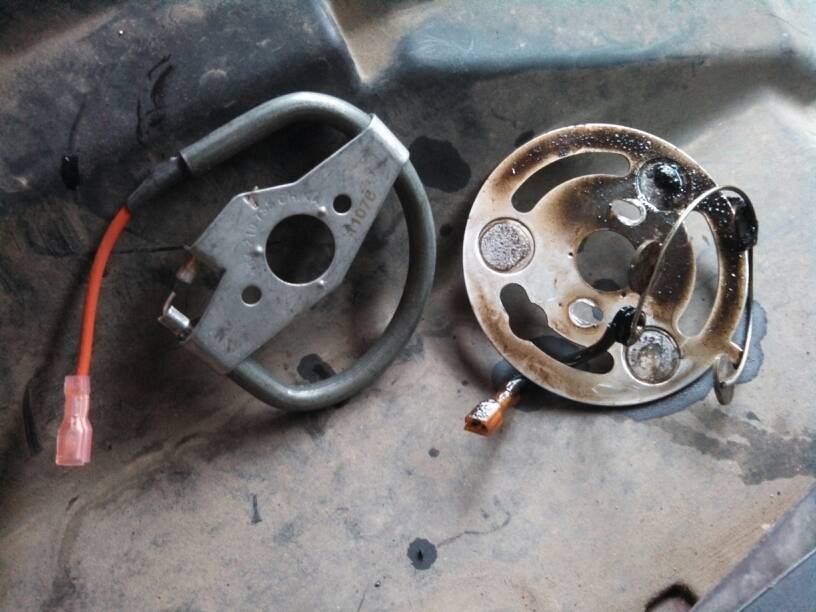

Still have stock fuel bowl? Heater could be bad causing the fuse to blow. Had this happen to me and no start like you say.

The screen shots are the only issues I can find with the truck! Thanks for the fuel bowl heater. But like I said it only does it on cold starts ( meaning it sat over night with out running). I will check fuel bowl heater. Thanks

Yep fuel heater bowl
and there is a new one from
Dorman.
Thanks for the help.
