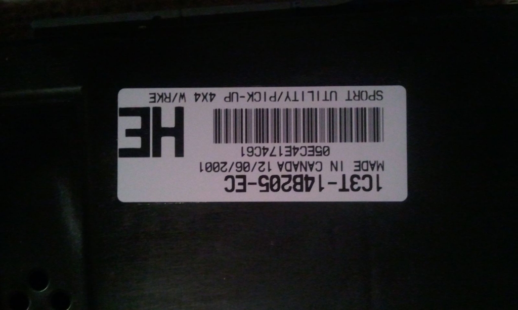

Looking for a GEM module for my 99 F250. Code D. Let me know if you have one.
Exact engineering number is F81B-14B205-DJ but I believe as long as I have a D model I should be okay.

I got this one from an 01.

Fixed some of my problems but I still have some more that I am trying to figure out the cause of. (ie no 4x4 light on the dash and 4x4 not working, power locks) but the old GEM module was so corroded when I took it apart that it needed replaced no matter what.

If you purchased the one pictured it will not work right in your truck. I dont know if you did its just a heads up.
