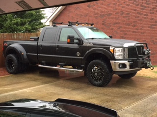

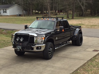

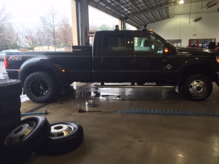

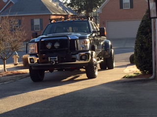

Well I went with Fuel Offroad Dually Cleavers (20") with Toyo MT 295/65R20E and I really like how it turned out (see one before and remainder after photos). I drove this way with spedo about 11% off for 3 weeks with no issue but today went to Ford Dealer for service and they were able to reflash computer for 275/65r20E tires (an option of the single rear wheel F350s) and now spedo is only about 1% off.
