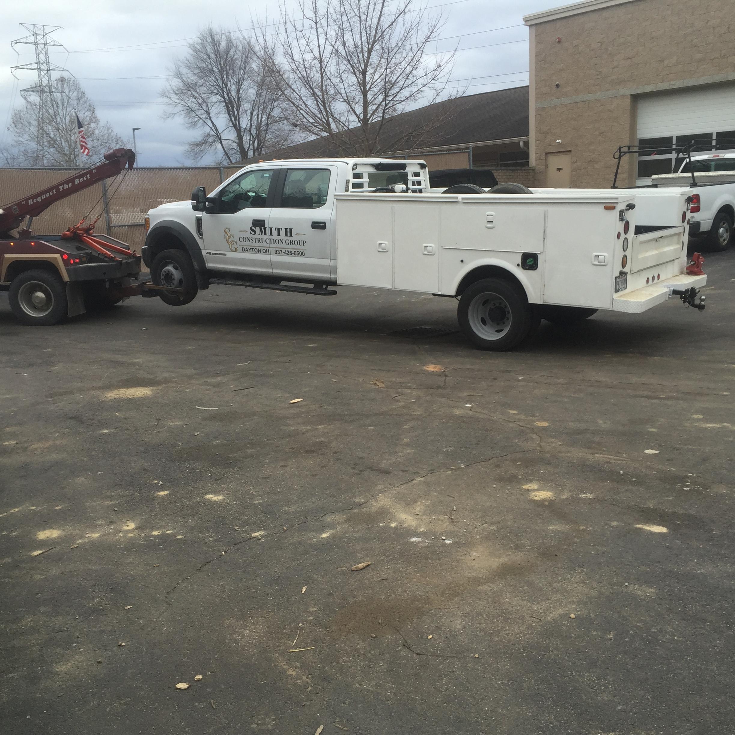

Well we have owned the truck for two weeks and it is headed back to ford. Got the call at 6am this morning from our driver that it was dumping transmission fluid everywhere. Called ford roadside assistance and had it towed to the dealer. They called a few minutes ago and said that the seals for the transmission lines had failed where they bolt to the transmission. Nothing to major at this time, but still sucks for a truck with less than 1000 mile on it. Anyone else had any issues like this?

i hope he disconnected the drive shaft to tow like that...

Got the truck back today. They replaced both of the lines that run from the transmission to the transmission cooler and all of the associated seals. Seems to be good to go now. We will see as it is leaving to go to GA on Sunday.
