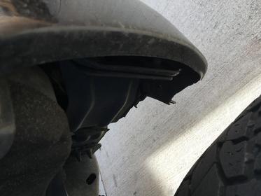

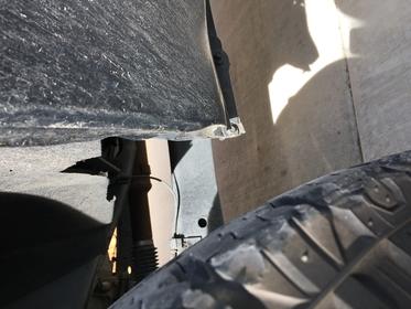

Here is my trimming with 35.12.5 on20x10s with 3" spacers
Raptorgabe
Jun 6, 2014
447
Full lock no Rubin on flat ! Don't go off roading though ! If u hit a big bump at lock prolly rip bumper off

i cut about an inch off the inner fender it self than shaped it sorta like stock to where its not noticeable unless ur looking for it ! the bumper i had to cut the bracket off and a inch off the bumper atleast
