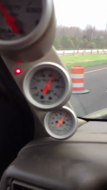

A couple weeks ago I pulled a 315 new holland square baler (3000lbs) on a 28' gooseneck trailer about 200 miles one way. At 65mph 1900rpm, 950*egt, 15psi of boost, pulling any steep hill my 38r surges like crazy it's so Loud I almost wanna stop so I don't hear it, this can't be good for the turbo or the truck, so is there a problem with my turbo or is this normal for a 38r.
Also if I get up to 70mph, 2100rpm, 1050*egt, it won't start surging until 20psi but it surges just as bad
Any help would be great
Extra info: I have bellowed up-pipes, ebpv completely deleted, 38r has 14,000 miles on it, surges with or without my water meth on, I run -20 blue windshield washer fluid,
It didnt surge at any rpm on our way home, I got up to 20psi once on the way home but mostly ran below 15psi the whole way
My phone won't record sound and the video is kinda crappy but it gets the point acrossed.
http://i1282.photobucket.com/albums...26399A6-9290-00000B99DE96C203_zps4ae87253.mp4
