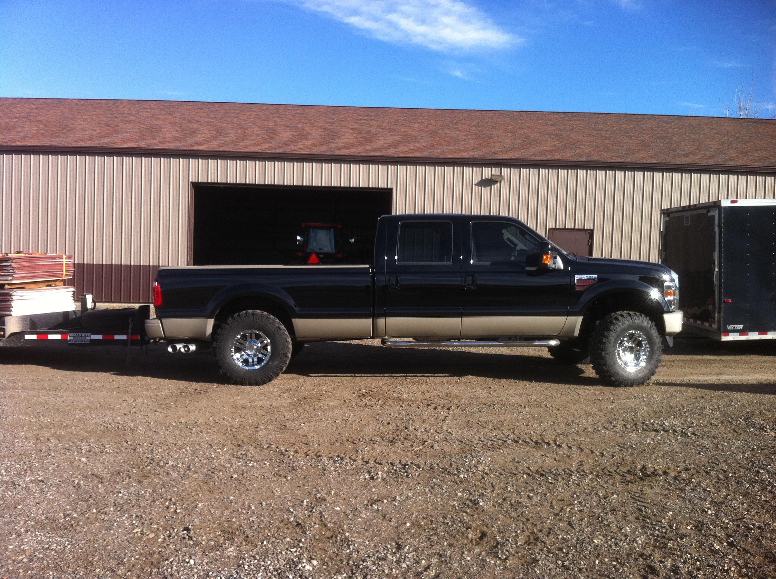

I just installed 325 x 20" (which are 35.7" tall X 13" wide) on my 2010 F350. I built custom dual shock mounts for the front, have stock height...no rubs. Just a point of reference.

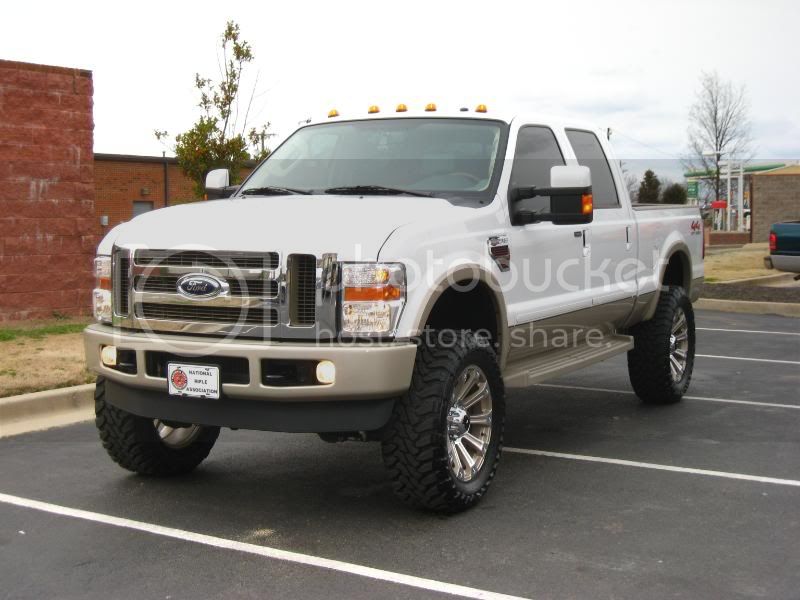

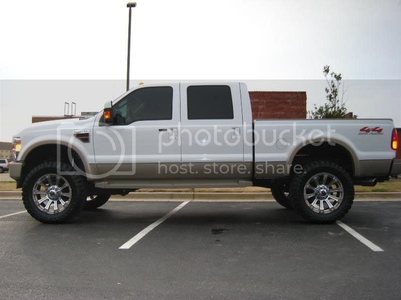

These pictures are from a long time ago. I had just installed the icon 4.5 kit. I know you wanted pictures of 4inch but I figured this was close enough.
6inch block in rear
22s with 37s
didnt rub at all

thats a sick lookin truck! honestly i have never been a fan of those wheels with the exception of your truck! they just fit it perfect! i love them on that truck and believe me ive looked at your truck more than a few times on other forums as well its just plain sick! i wish i could afford 22's but right now being in college and trying to get my own shop going its hard to let go of the money when i need it for other things as well which is why im doing 20's
