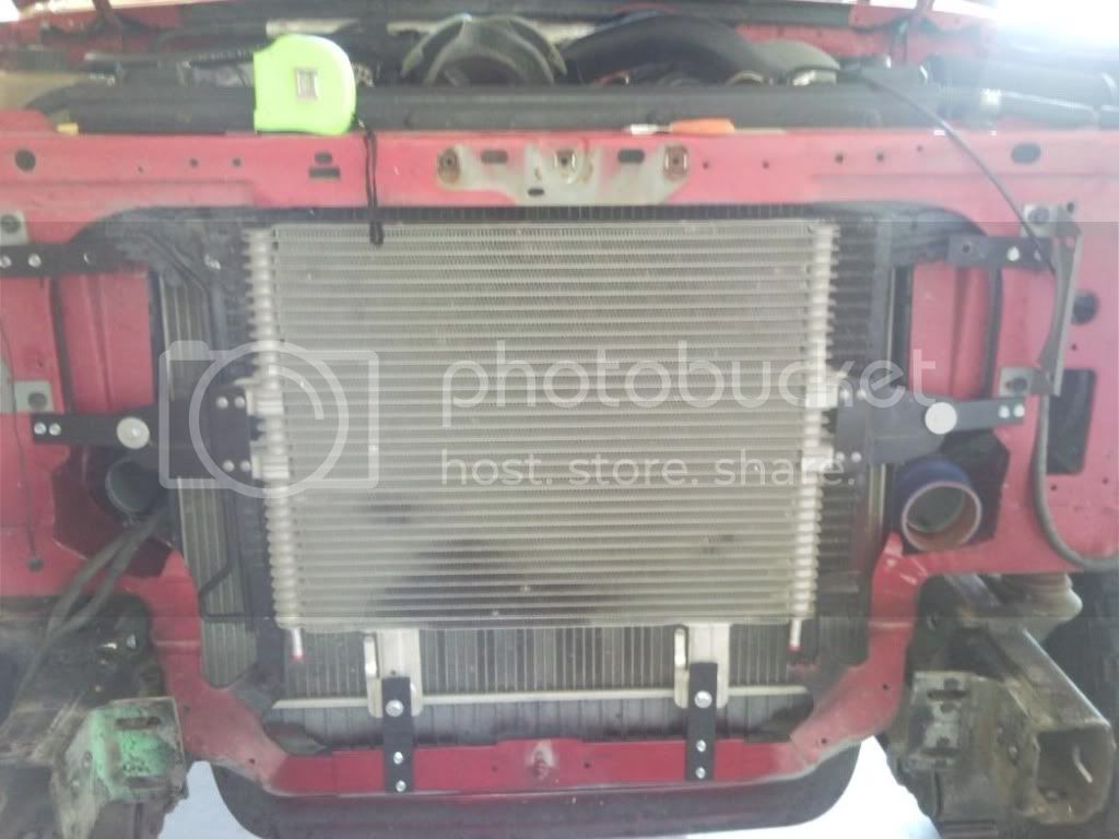

Hopeful this will help you guys see the size difference in these coolers, I personal would put a 31 or 26 row 6.0 cooler in before a tru-cool
4r100 and 5r100 trans comparison
31 row on obs
TRU-COOL 4739-1 TRANSMISSION COOLER
I also have some 6.0 coolers for sale if any bodies is interested shoot me a PM
http://powerstrokearmy.com/forums/showthread.php?t=42349
