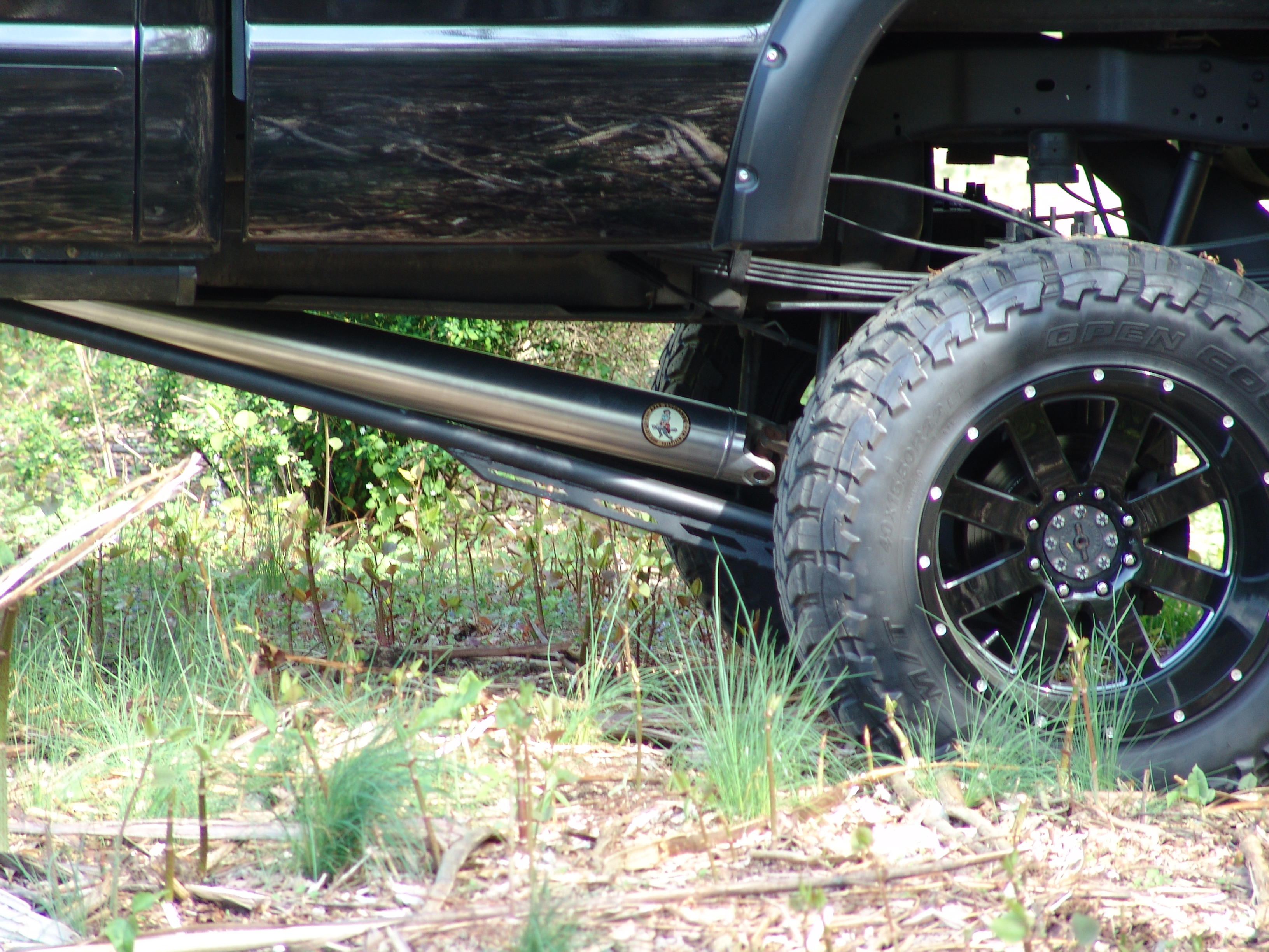

Im running a 5'' steel 1 piece driveshaft from CCI on my pulling truck. Great quality and price. You wont be sorry.
