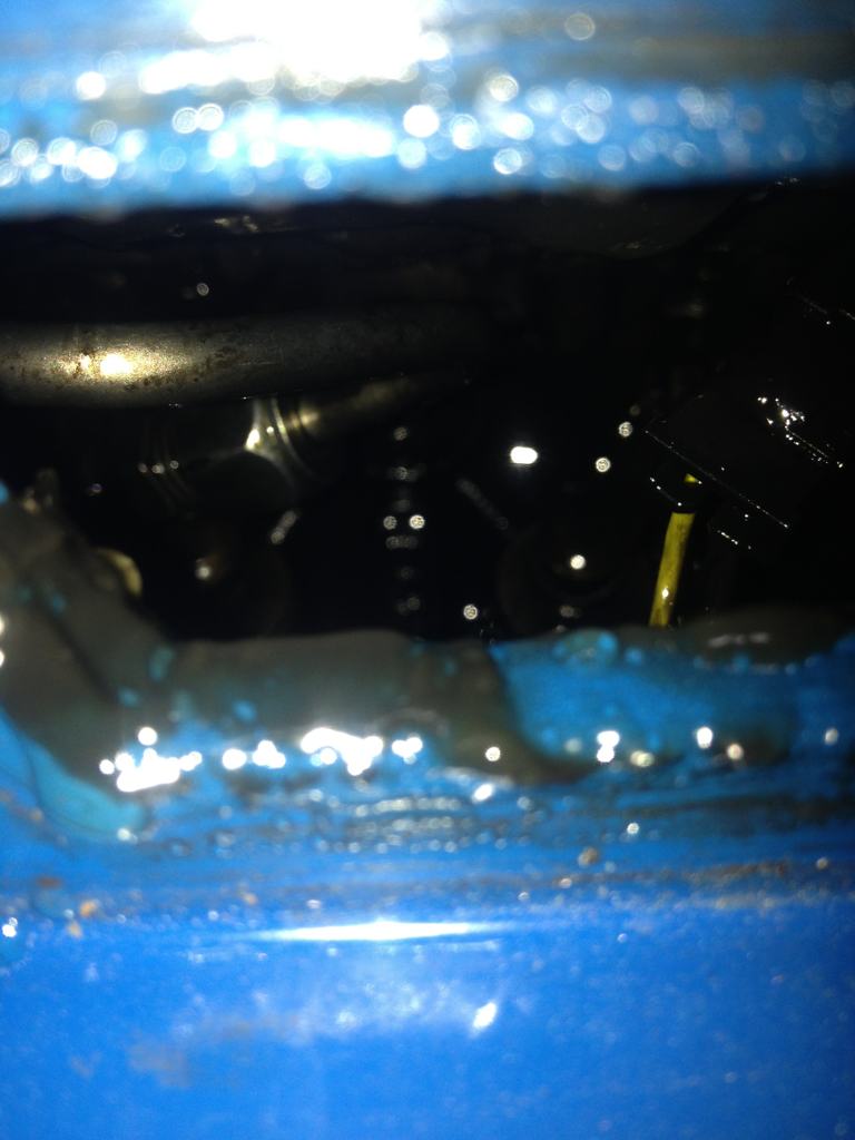

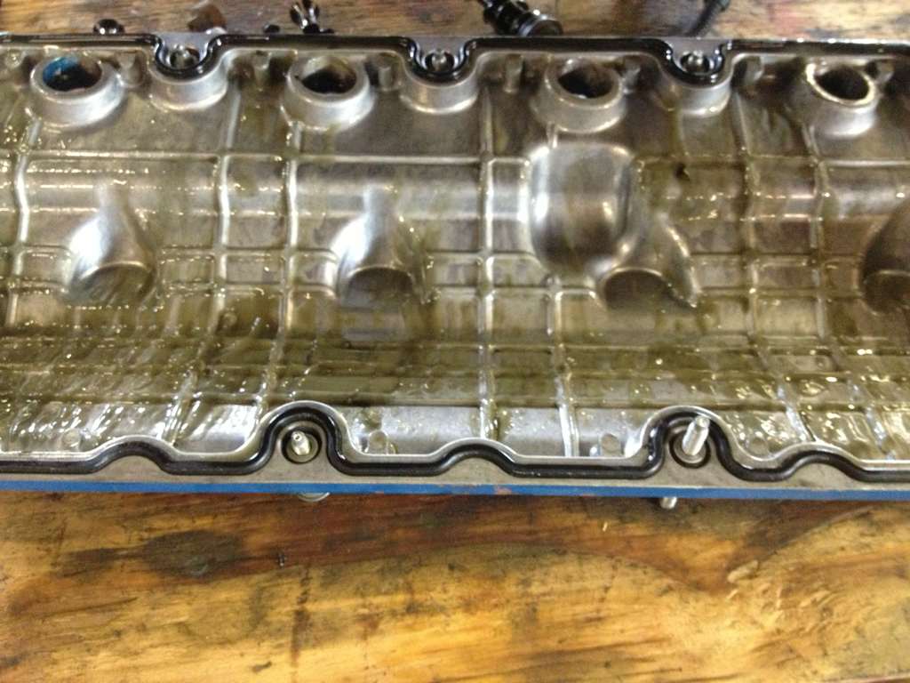

ImageUploadedByTapatalk1384664312.828319.jpgImageUploadedByTapatalk1384664352.024604.jpg
If it looks like this on the oil fill cap or under the valve covers...most likely a cracked block. Which would be very unlikely with the truck not being studded.
