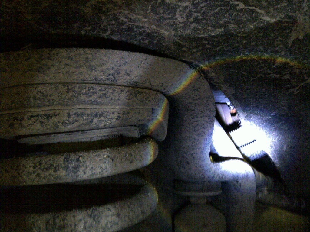

Spread the bottom cooler and exhaust flange towards the back of the engine on the driverside. You will have to pull the inner fender well to make it easier. If there is coolant in the cooler something is a miss.
Its the flange just above the bright spot. Can be a bitch to get to. There should be a small plate between the two faces that is a 1/8" thick. If they did a full delete then the cooler will be MIA. If thats the case... Likely HGs.
