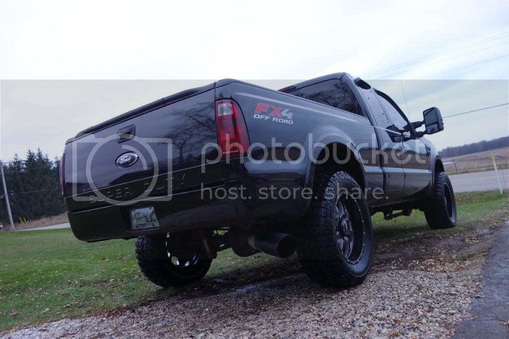

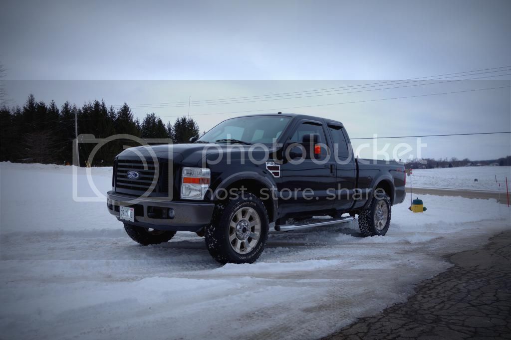

Heres a few pics of the truck.
When I first got her.

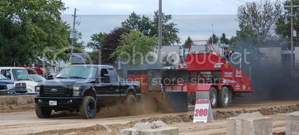

Pulling tires and wheel set up

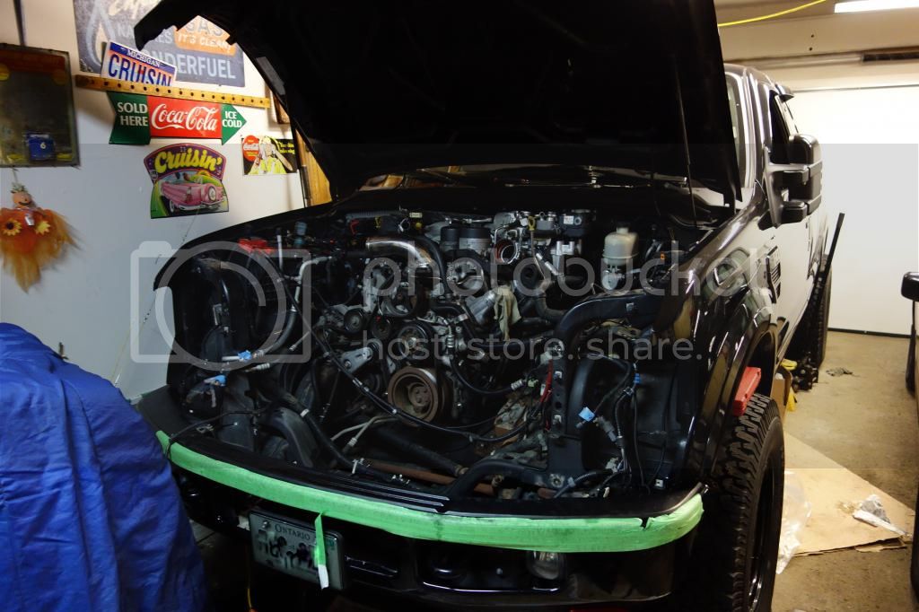

Progress so far
Working out of a fairly small 2 car garage lol everythings removed top side just struggling with some seized cab bolts and front driveshaft bolts at the moment but hope to have the motor and trans pulled soon so I can dig into the motor and start ordering some parts!

Didn't know I had to lift the cab up a few inches till a buddy from a local diesel shop told me I had to too get the motor out lol pulled a few mustang motors before but this is my first diesel motor, been a lot easier then when I did the head studs cab on on this truck.

Pic from last pulling season you guys might like
Cant see the smoke that well but it would make the crowd disappear on the right side of the track lol
