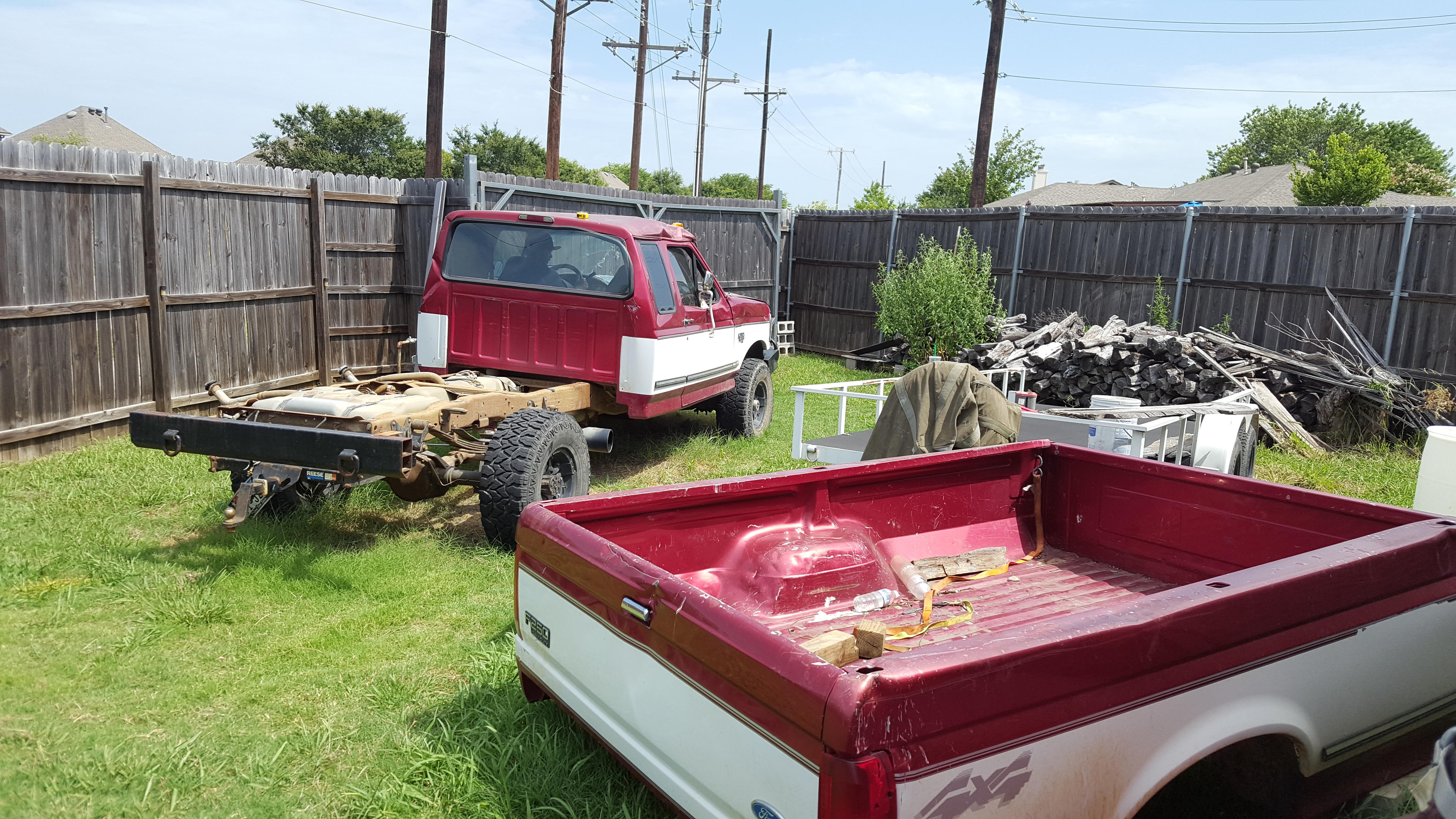

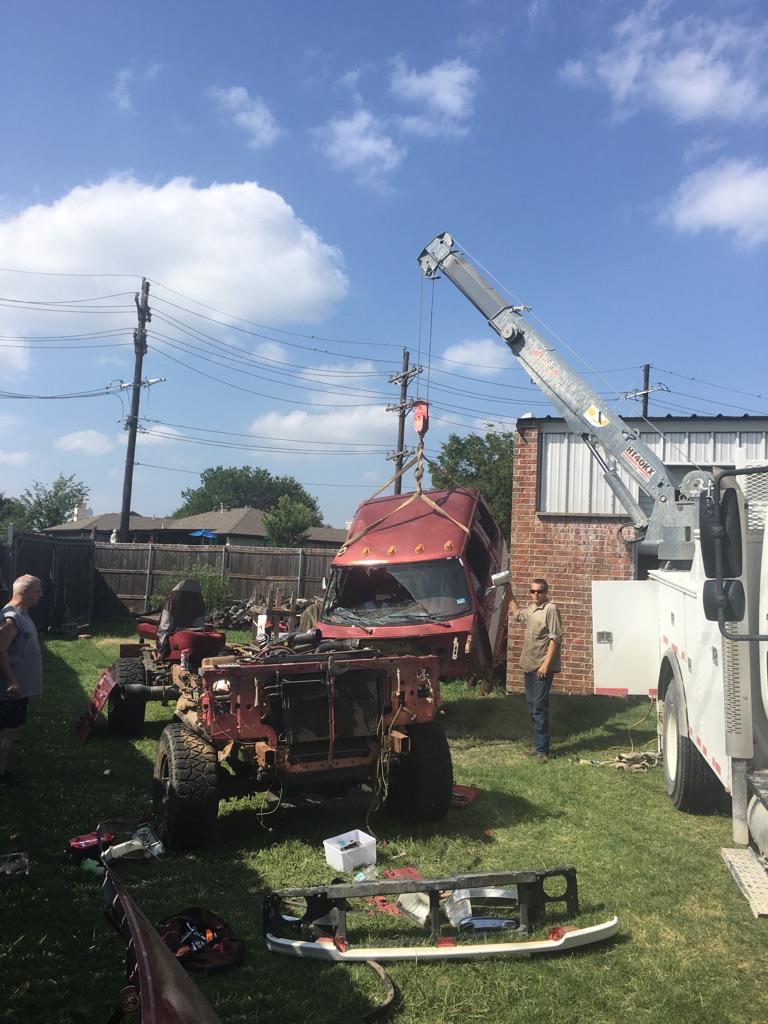

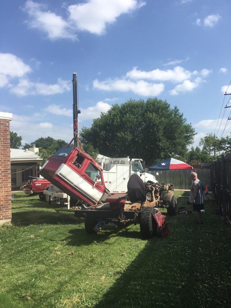

Just happened by chance on July 3rd, but yesterday, i helped my buddy remove his cab and bed on his 1997 F-250 he rolled almost a year ago. Haven't seen much about obs cab removal, so figured id post some pics, and if anyone has questions, I'll be happy to answer them.

I'm planning to remove my cab and fix some sheet metal that I destroyed trying to get my irate down pipe installed. I also want to spray on some lizard skin or something to help with the road noise.
How long did it take? It really don't look too bad. Anything special to look out for?
ghohouston
Dec 2, 2012
4,022
15
Lewisville,Texas
Only took a few hours (i wasn't watching the clock). Keep in mind you will need to suck the a/c down, or be prepared to do it the other, non friendly way. There wasn't anything "special". If you have worked on fords before, you should be fine. The can cant weigh that much, it didn't even make the body of my service truck roll any. Id say a few hundred pounds at most.
iowacornfarmer
Jun 28, 2014
98
Don't forget the ground strap when you lift it otherwise it's straight forward, done many.
