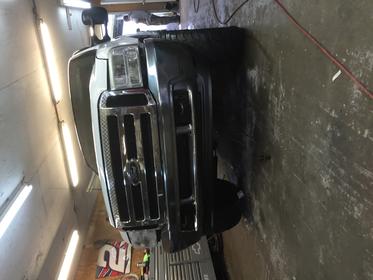

Yes it was. I had to fix that. That was taken last week. I opted to use my 01 bumper with the 05 grill and drop my bumper down. I have made something to fill in under the headlights. Just haven't been able to install yet. Hopefully today I can get a few things done. We used a blackout chrome kit on the bumper. It looks pretty good but the paint didn't stick very good. I'll end up buffing it out back to chrome. Eventually I'll buy new grill and headlights and build my own bumper. Also a new paint job with gun metal gray at the bottom and white with bush whackers
