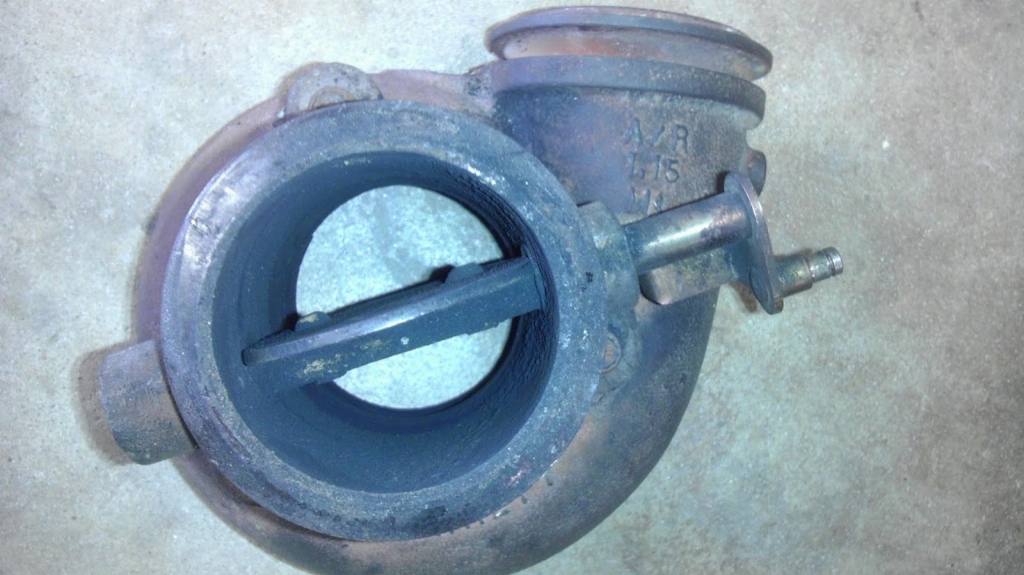

[QUOTE="PatMan, post: 645529, member: 10060"] Uhm, not from what I've seen. I've torn down 2 turbo's, one from an SD, and one from a van. Both had the same internals - just the housings were different. And I'm using the turbine shaft from the van's in my project turbo build. I needed a gated housing - and managed to pick up a Banks housing on the cheap. Here's the link to my build, (more like re-build+upgrades) [url]https://plus.google.com/photos/111707250377972824380/albums/5755962361649501393[/url] and here's a photo of the van's shaft/turbine and the back side with the Banks housing. No difference in the turbine side as near as I can tell, and it clearances the housing fine. [ATTACH=full]107754[/ATTACH] [/QUOTE]
