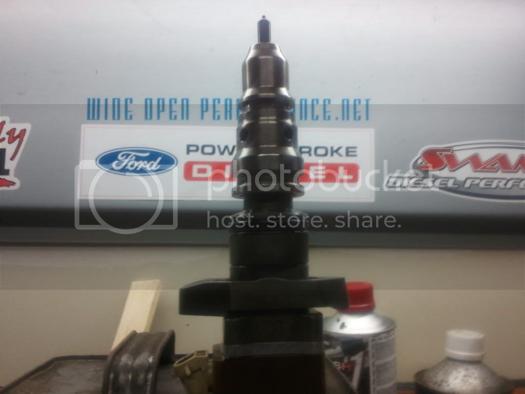

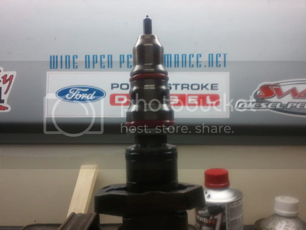

So I don't see many people saying much about puttung new orings on when the put a set of used injectors in. As I was replacing all the gaskets on the stage 2 injectors I'm putting in my truck. I was wondering can someone explain to me how these work. With the orings sectioning the injectors which feeds oil and fuel. Here's some pictures.

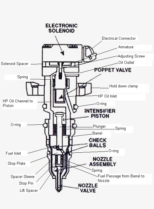

The copper gasket on the nozzle side seal combustion gasses out of the injector cup. The orings just down from that seal the fuel rail, and the orings closest to the solenoid seal in the HPO.

whenever i sell used inj. i always tell them to re o ring. just a peace of mind imo
