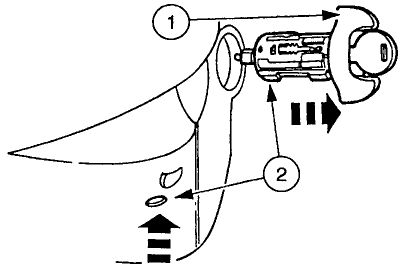

Here is what I have on the ignition switch.
REMOVAL
NOTE: The following procedure applies to vehicles that have functional lock cylinders and keys. If key numbers are known, the proper key can be made.
Disconnect the battery ground cable.
Remove the ignition switch lock cylinder.
(1) Position the lock cylinder to RUN.
(2) Using a suitable tool, push upward on the cylinder release tab through the hole in the lower shroud while pulling the cylinder outward.
