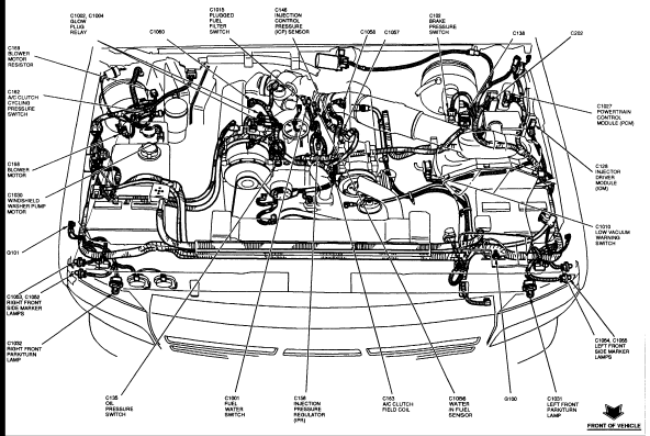

I just replaced the fuel pump in the valley between the heads, what a job! Now I am hooking up the wiring and have a problem. I have a wiring harness with three plugs on it and two of them go to the fuel filter. I can not find a place to plug in the third one, the last one on the harness. I forgot to say it is a 7.3 diesel with turbo.
Any experts out there?

Does this help any?

You should have 3 on the fuel filter. They are for the water in fuel light, fuel restriction sensor and one for the fuel heater.
Aug 12, 2011
454
12
Parker, TX
And the other one on the fuel bowl harness (aside from the ones Bugman mentioned) is for the Injection Pressure Regulator (IPR) on the back of the High Pressure Oil Pump (HPOP). Cheers!
