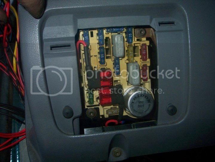

If I remember correctly there should be a aluminum cylinder looking fuse on the back of the fuse panel that powers those. Did you check that one?

The signal stat for the turn signals is on the backside of the fuse box the one on the front that you can see is for the hazards.
Do the hazards work?
Have you checked the fuses under the hood with a meter? #17 and #20
Is there power anywhere on the interior fuse box?

It's like the round one but on back.

That's a relay and not a fuse. The one that you can see if for the hazards and the one behind it is for the turn signals.

So the one on the back side has power to it not the one on the front if that makes since. Fuse 7 for the turn signals does not, I will check more when I get off work. Where can I get the diagrams you suggested so I can further diagnose this issue.
