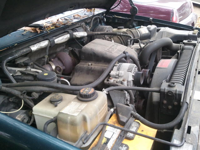

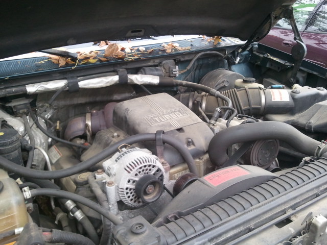

Hey guys here's engine bay how's it look? Looks like dark on top of coolant tank

Also, check the turbo. Take off all of that hosing from the middle bracket forward & shine a light down there. Take a look at the compressor wheel. With a stock airbox & that many miles it may have dusted the turbo a little.
Take the valley cover off & look down in the valley & look for oil leaks & fuel leaks.

Don't know if there is coolant, I will have to buy sight UN seen, and take the owners word, its a 81/2 hour ride so will have to give money for deposit. Do you think even if needing something this would still be a good deal? Thanks for all your input

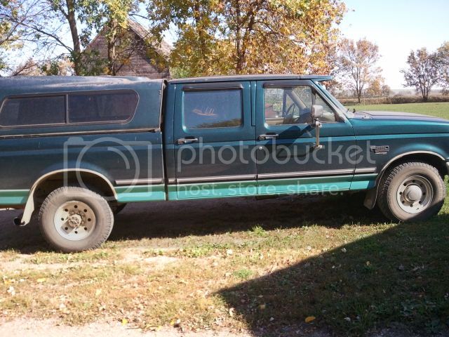

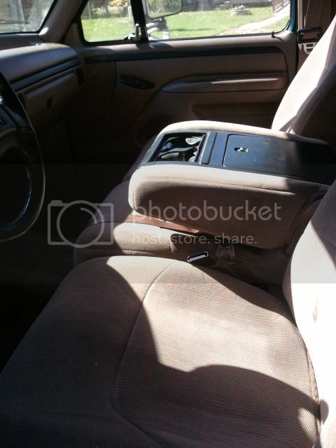

well if all goes as planned ill pick it up this weekend ,here is a few pics

He paid $3700! Haha. But that thing looks damn clean!! If the truck is all stock I am sure you will have no problems getting it home. But I wouldn't add ANY performance to it until you upgrade the tranny.
Make sure you check frame rust as well!
