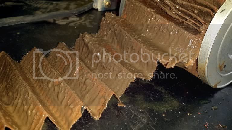

coolant filter??? I wasnt a believer til I took my first filter off in just under 1500 miles and found this...
I put the filter on 1500 miles before I made the ELC swap... no need to dirty fresh $$$ ELC

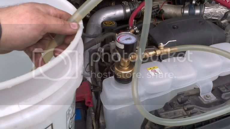

and if your not refilling VIA Airlift I should kick you in the balls

$50 for home made setup. filter and filter head from napa. some heater hose, clamps, t fittings. done
