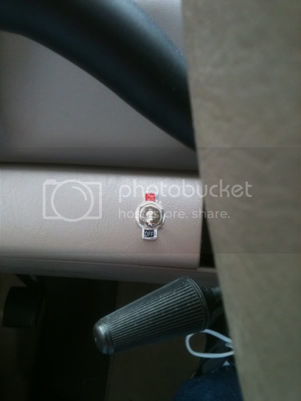

did the high idle mod this morning

How did you do the high idle?
I havent even heard of it for the 6.0L
Really Ivan? You've never heard of it for the 6L? I've did it to mine about 4-5 years ago...works slick. All you need to do is find the PTO wire in the harness that comes through the firewall and the 12v power wire behind the dash(kinda where the wires are for the trailer brake hook up) then hook them both to a switch.

If you have upfitters you dont even neet a hot wire.......
All you gotta do is hook the pto wire to your preferred upfitter switch wire.
Took me a total of like 20 min to do it.

yeah i know that...mine is an '04 and Ivans(extendedpower) has an '03. Wish mine had the upfitters. I could add them, but no need now.
