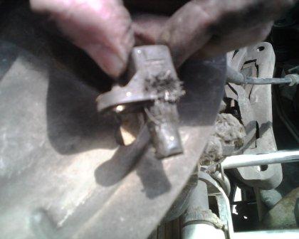

When my hub went, it took out the ABS sensor. Hard to tell in the picture but it rubbed the end of it. Could be your problems are related??

I believe the late 99's don't have the ABS sensor. I finally have some time and am going to first pull the lock out off and drive it around to see if that is the problem. If that doesn't fix it, then I think it is a bad inner axle bearing.
