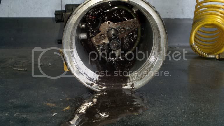

alot of people when they change fuel filter they just pop and drop... maybe take the time to take the bowl out and clean it.. good chance to reseal it too...
dont want this!!!!
Viking
Sep 5, 2011
2,055
Minnesota
Dear lord that doesnt look good at all, would deleting a fuel bowl be better?
then again all that gunk ends up in your engine and injectors

That fuel bowl is not like that because of lack of maintenance. There is oil getting in there somewhere. Mine came off for the first time in its life at 235,000 miles. It was clean as a whistle.
91turbogsx
1,554
Gardner MA
If you deleted the fuel bowl you would be installing a post pump filter elsewhere so you would still be getting the proper filtration.
Nope... guess again... that isn't oil... Its mill dust... It came off a mill truck. Sure if had a new fuel filter when it came in, and they change them religiously, but when you fail to pull the drain, clean, than install new filter, it builds up... I had to take this one off because when I went to open the drain, nothing happened
TyCorr
Jun 23, 2011
15,461
I can vouch for this. My bowl had so much dirt in it that when I went to drain the bowl to fix a leak nothing happened. The dirt was sooo packed into the drain valve it scored the ball. It dried like epoxy. I had to remove the valve and drill the crud and then chip it out. That was with 240k miles. I change my filter three times a year. Ive never changed one because I HAD to. I always keep em changed. Being off road for the first 230k miles my truck had dirt under it everywhere. Apparently it was getting into it also! LOL
