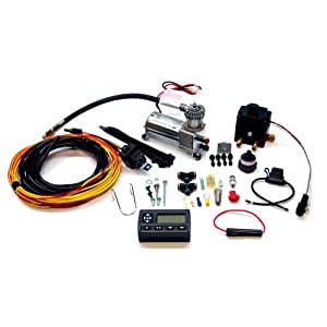

Yeah the airlift wirelessOne controller doesnt have a tank or anything special. It gets the job done for me though. It's not going to be the nicest kit out there for a compressor but since im not airing tires or anything with it it does fine. If you want the best firestone bags with the valair stuff and you can have onboard air on the truck

I have had both Airlift and Firestone ,, both good kits and they extend the warranty on the Airlift bags if you buy the compressor at the same time .. I would opt for the wireless way easier to install and will maintain the bag psi you select ,, the compressor can be wired to the trailer plug wiring and mounted up inside the spare tire area so it's a very clean install ..
I don't even run the shrader valves
I like the wireless 7200 vs the wireless one myself
