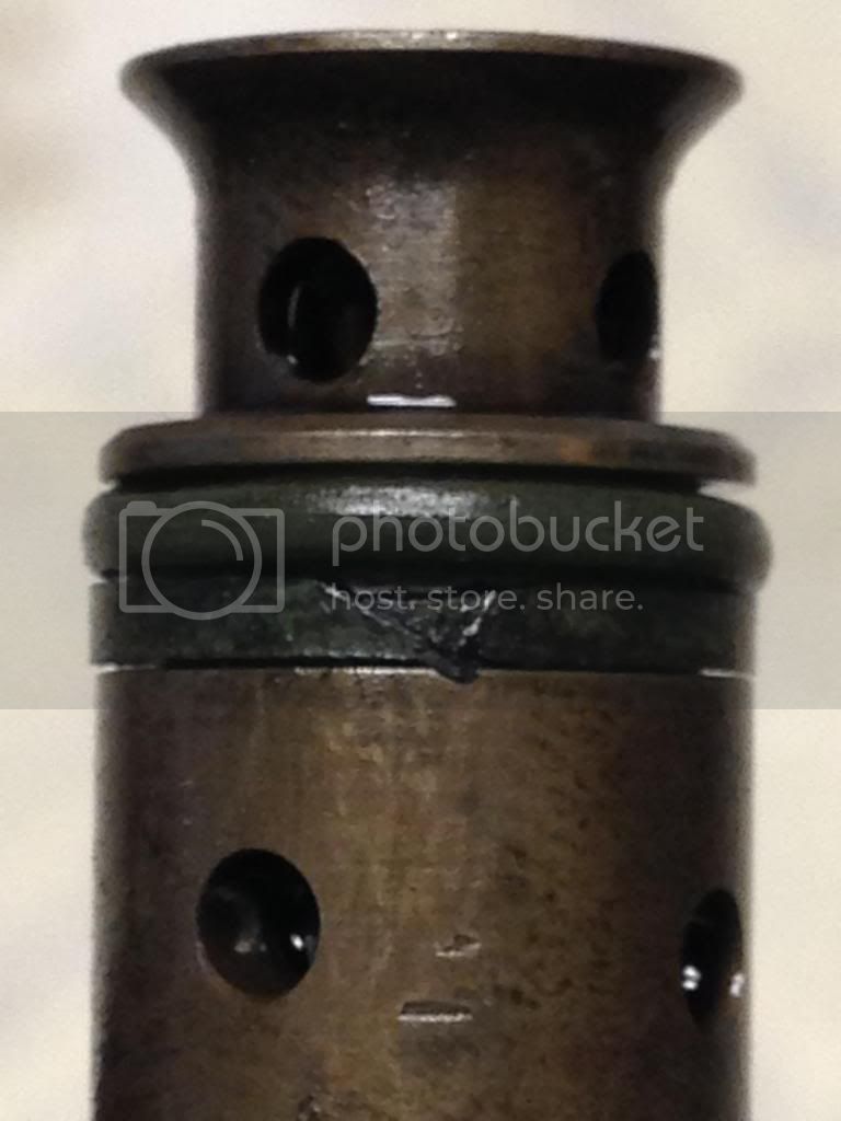

would this do it? the other two look fine

If it is covered in oil it just may be it.
Here are the part numbers from the Nation
IPR Connector with 12" Pigtail
(International) 2501107C1
IPR O-Ring Kit (for when IPR valve replacement is not required)
(Ford) F6TZ-9C977-AN (F6TZ-9C977-AA?)
(International) 1825806C92 (1825806C91?)
IPR Injection Pressure Regulator
(Ford) F4TZ-9C968-C (engine serial no. 187099 & before or pump no. 255C92)
Part number F4TZ9C968C was superceded by part number 2C3Z9C968BA
(Ford) F81Z-9C968-AA (engine serial no. 187100 & up or pump no. 247C91)
(International) 1824982C91 (engine serial no. 187099 & before or pump no. 255C92)
(International) 1833798C91 (All Years ???) latest part number
(Motorcraft) CM-5013

im at a loss here , went to ford and got the o rings , still does the same thing , not even a minute after shutting off it just cranks and cranks wanting to start , iv read symptoms of a bad ipr are rough idle and driving , this thing idles perfect , drives perfect , perfect throttle response and everything , something is still up with my electrical system as when under heavy throttle the battery gauge comes on and flickers , and the gauge is at half even when running and operating temps
