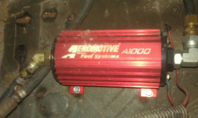

any interest in a a1000 pump?
speedracer1000
Sep 18, 2011
418
everett, pa
i got it now. 200 shipped today, heres a pic, its a lil dirty but works well

How does this plumb in? If the OEM hfcm still used?

theres alot of different ways to do it, u should run a filter and water seperator with it tho, and jus run it up to your reg return

It won't hook up to the stock lines. Kinda made for a custom setup and larger fuel lines.

requires a 5/8 suction tube or sump and 5/8 feed line from the suction tube or sump to the pump, I would recommend a 20-30micron water separator before. pump and a 2 micron absolute after fed direct via a y-block the the front of each head with 1/2" line and regulated return run back through the factory feed line to the tank
