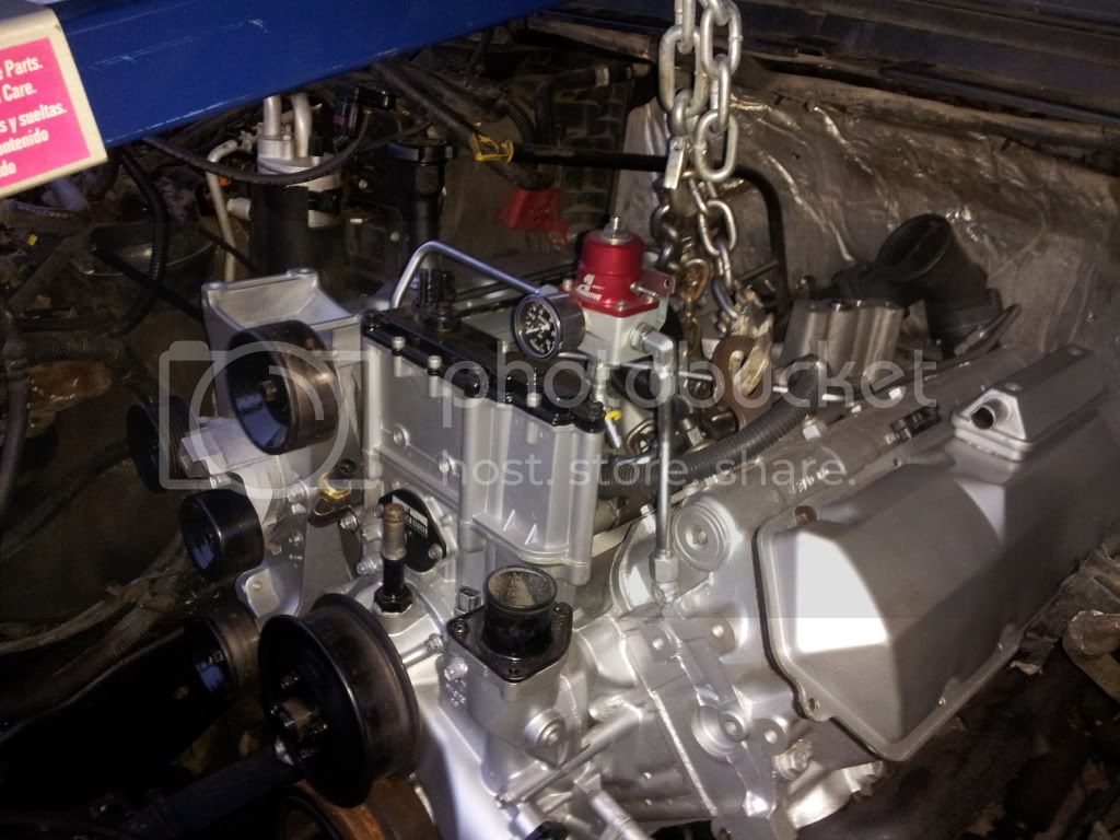

Notice the tube is moved to the left? Ill see if I have a better picture.

Yea chris the oil is flying off the gears in there! Lots messier than you'd think.
Glad you got it figured out. As sad as it is to say that cover was one of the easiest "mods" ive done. I bolted it on and never had an issue.
I got it to use with a gen 3 or twins but never ran them.
I like the silver for spotting leaks but wish id have cleaned it a little better, the block anyway, before painting. Its made it through two salty winters with no issues. Manifolds have little "dots" of rust poking through the vht header paint. I could wipe them down and spray them again and they would be fine.
