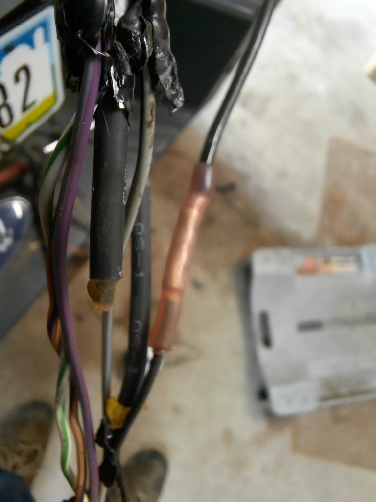

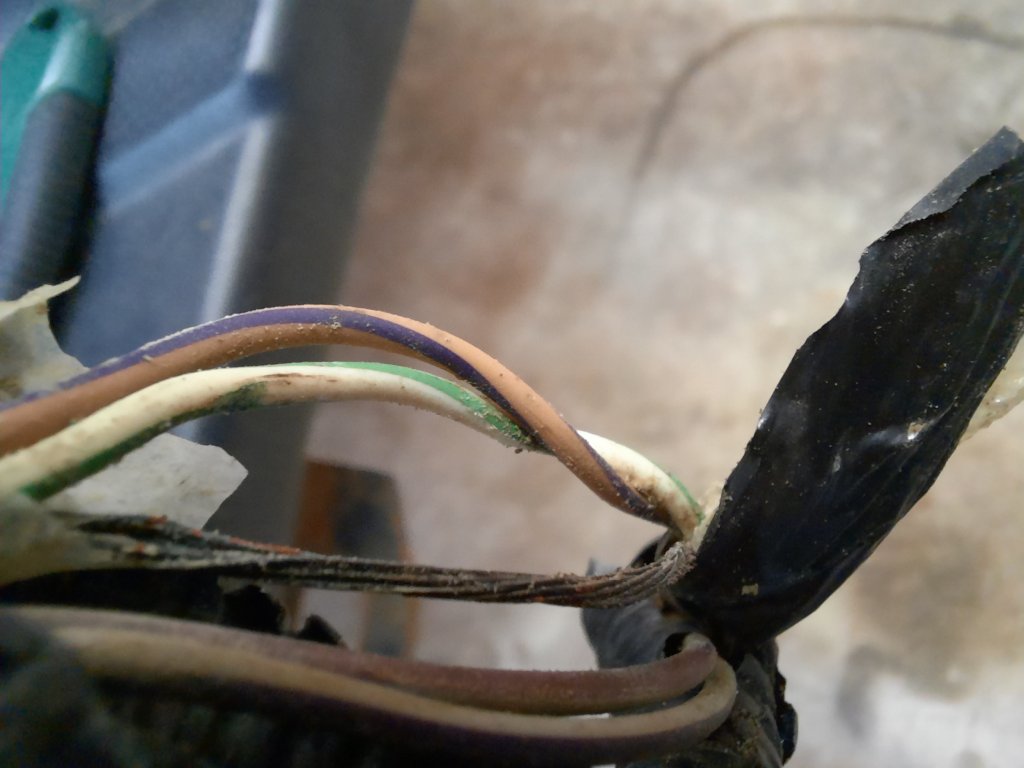

Commonly talked about is the ground wire in the harness running through the tailagate.
I opened up the harness and it was intact but very corroded. I cut the wire at each end and spliced in a new ground wire.
Didn't fix my problem.
Of the two black wires in the plug only one is used, so you have to cut it apart to see which one it is.
Seems kind of silly to have an uninsulated wire, but I wonder how important it even is.

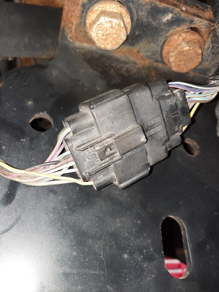

One place talked about is a junction box under the dash near the emergency brake. I wiggled everything under there with the Cam on and no change.
So next I dug into the plug back by the trailer hitch.
When I pulled it apart I didn't see any corrosion in there. But I was shocked at how much water came out.
Dried out as much as I could, greased it and put it back together. I was maybe slightly better but not fixed.
So I thought if they used a bare ground wire in the tailgate, then maybe that is the same problem here.
I opened the harness and yes, bare ground wire. I used a jumper wire to ground it. No change. It was not dirty or corroded like the same wire running through the tailgate.
Eventually I took the plug back apart. Cleaned the pins with some emery cloth. Greased it again. back together and that fixed it.
So my problem was this plug back by the trailer connector.
