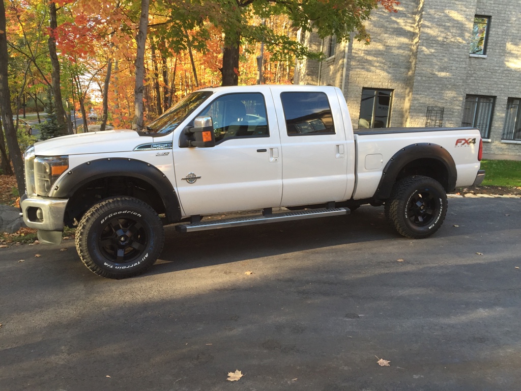

Hello .
I have a F250 2014 with 2 " ready lift kit
And 34.6 bf goodrich tire. The wheel is to tight and when i turn the wheel the tire
Don't pass :( .What is the minimum high for
This seize of tire ?
Sorry for my poor english speaking.
I am from montreal canada and i am a french
Guy.

2" will clear a 35" tire fine. The question is what rim and offset are you running, that makes more of a difference in clearance issues.

It dosent fit maybe because i have 2" spacer ! But if i put 4.5" lift kit . Maybe it will fit ?

I run a 2.5" lift with 35x13.50 tires on 20x10 rims with a -25mm offset. I had to trim some of the inner fender liner behind the wheel to get them to clear correctly at full lock. Maybe you could try that or pull the liners back to get them to clear correctly. I think you have enough of a lift. Like I said rim size is a huge part in to play with what will clear, more so than the height of the tire.

I aleraydy try to trim the fender and its not clearing it :( if i want it to clear i have to cut the body whit the paint :(

Just the small pinch weld part? I had to cut a tiny bit of pinch weld and a little bit of the fender flair too. Only other suggestion I have that could be cheap is to get a 1" spacer and stack it with your 2" spacer to get some extra height.
