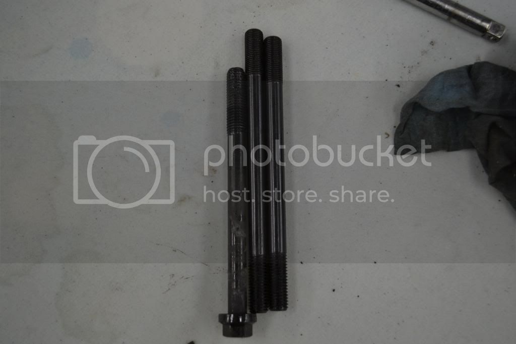

What about the ARP head studs? I do need to pull injectors to do all the studs, right? Will I have to get new injector o rings?
Yes, injectors will have to be pulled. Also you need to remove the upper injector hold down bolt. Look for the 8 shorter ARP studs in the kit. The top of the stud should be even with the top of the nut. The max you want to see is a thread or two; anything more, the injector hold down bracket is not to slip on easily.

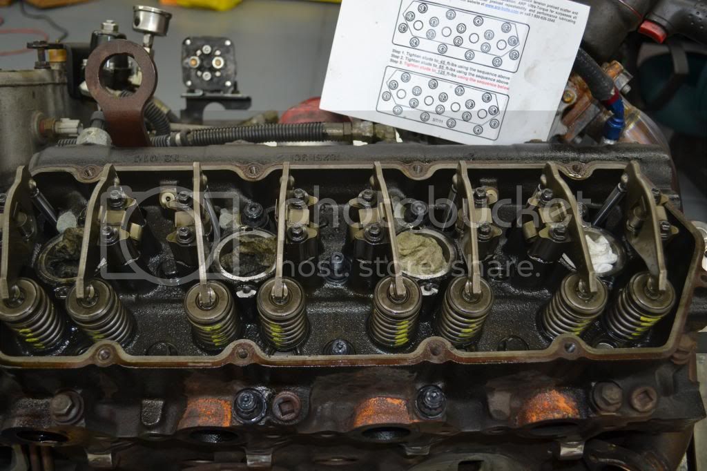

how can you do a "hot" re-torque if you have to pull the inj? by that time most everything will be cooled down quite a bit.

Good question. Gotta drain oil and fuel in galleries. Then loosen bolts on injectors. Gonna be pretty cool by then.
not meant to be a hi-jack
Simple... Start the engine without the valve covers or IC pipes on it. You could even just set the valve covers on it with just one bolt hand tightened. Once the engine is up to temp, shut it down and it should only take about 5 minutes to have the injectors out at the most. Don't worry about draining the oil rails or the fuel rails. They will drain into the cylinders and you can vac them out after the retorque is done. I never touch the rail plugs anytime I do injectors anyways. If the injector o-rings were new and your pulling the injectors for a hot retorque, you don't need to put new o-rings on them again..

30 mins from running to injectors on their way out for me. Just have tools ready and remember it will be hot.

Still say I'd let it idle with no IC pipes and just one bolt in each valve cover or no valve covers until its warm, shut it down and do the retorque. You'd have injectors back in it before it even cools down. Lol
