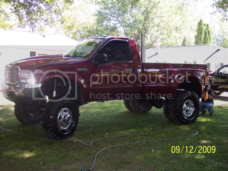

My buddy ran 38x 15.'5s in the front on his dually and they rubbed bad. Dente up the bottom of the fenders pretty good just from normal driving. He put big spacers in the rear and ran the same size in the rear. He had 38x11 boggers before on it and they didn't rub at all except on the leaf springs real bad if he turned the wheel close to full lock. Tore a lot of lugs off the inside of the front tires. I would not suggest boggers just because the lugs stick out so far.
38in boggers
38x15.5's

that truck had stock rims, i wonder if the OP will be adding rims for more clearance.. if not, i wouldnt even go as high as 8" maybe 5.5" icon kit and 37s??
