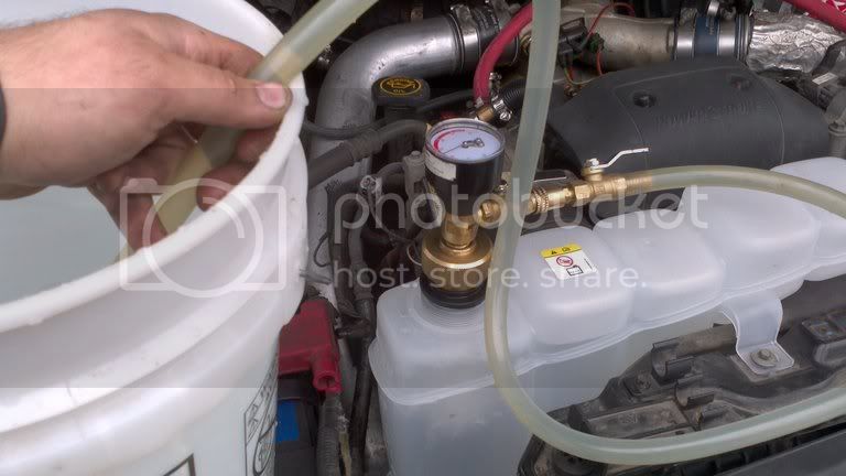

amazon airlift coolant vacuum fill. Best $110 you'll spend
907DAVE
2,166
AK
Love mine. It can refill a cooling system faster than I can pour it in.
907DAVE
2,166
AK
Do you hate bleeding air out of a cooling system?
If the answer is yes, then yes.:)
TARM
2,439
Yes those kits which are rebadged under all kinds of names are awesome. None of the spilling and splashing. Trying to keep it all in. Stopping to let it purge some air bla bla bla. You can get them anywhere from $300 for a Snap on version to $75 for the basic no name versions.
