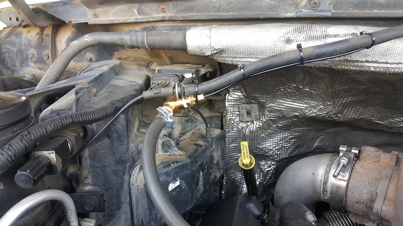

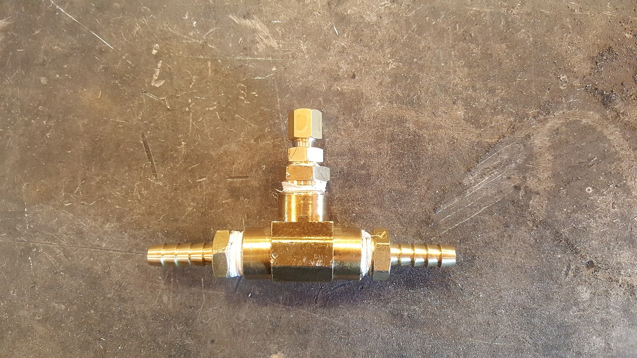

So then i was trying to find a better spot to plumb in this 1/8" nylon hose with a 1/8" NPT fitting on the end. It was difficult to find a place that wouldn't involve drilling and dropping metal shavings into the intake, and was also practical. So i decided to tap into the hose that connects the intake and the MAP sensor. With some fittings from Lowes, i was able to make a T that connected the 1/8" NPT fitting to 2x1/4" hose barbs. Cost me about $15.
And installed:
