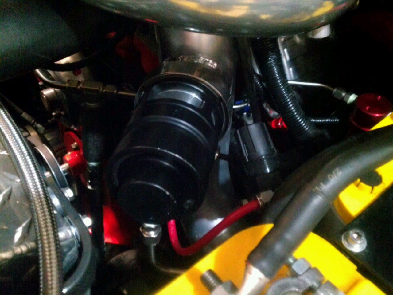

You got a pic of yours all plumbed up Ivan?
Not with me. (Just checked my phone.) I thought I took a picture of it, but I did not. I can ask the wife to take a couple and send them to me to post up.
