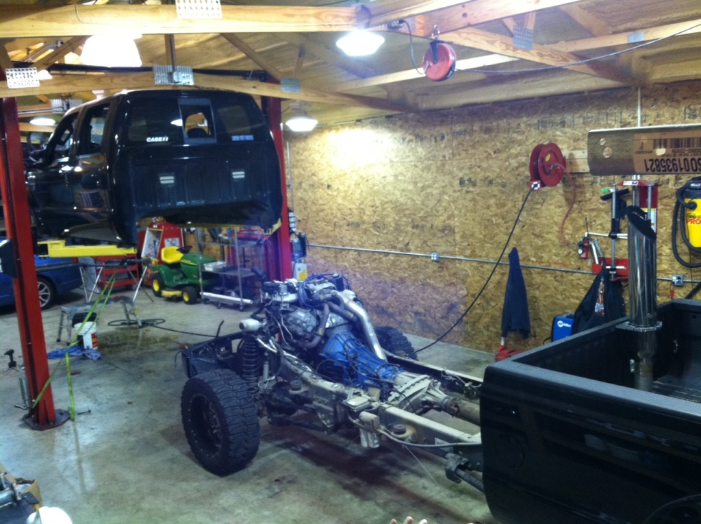

2 hours in
2 years untouched under the hood

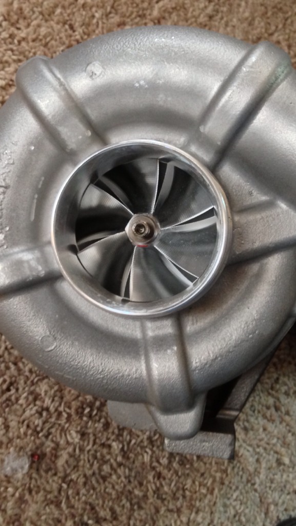

Little Turbo Porn, big thanks to my buddy JD.

Just need to put on passenger manifold and begin reassembly.
I've never got to pull my own cab, so this has been a huge learning experience for me and my buddy Chris
Thanks Everyone
