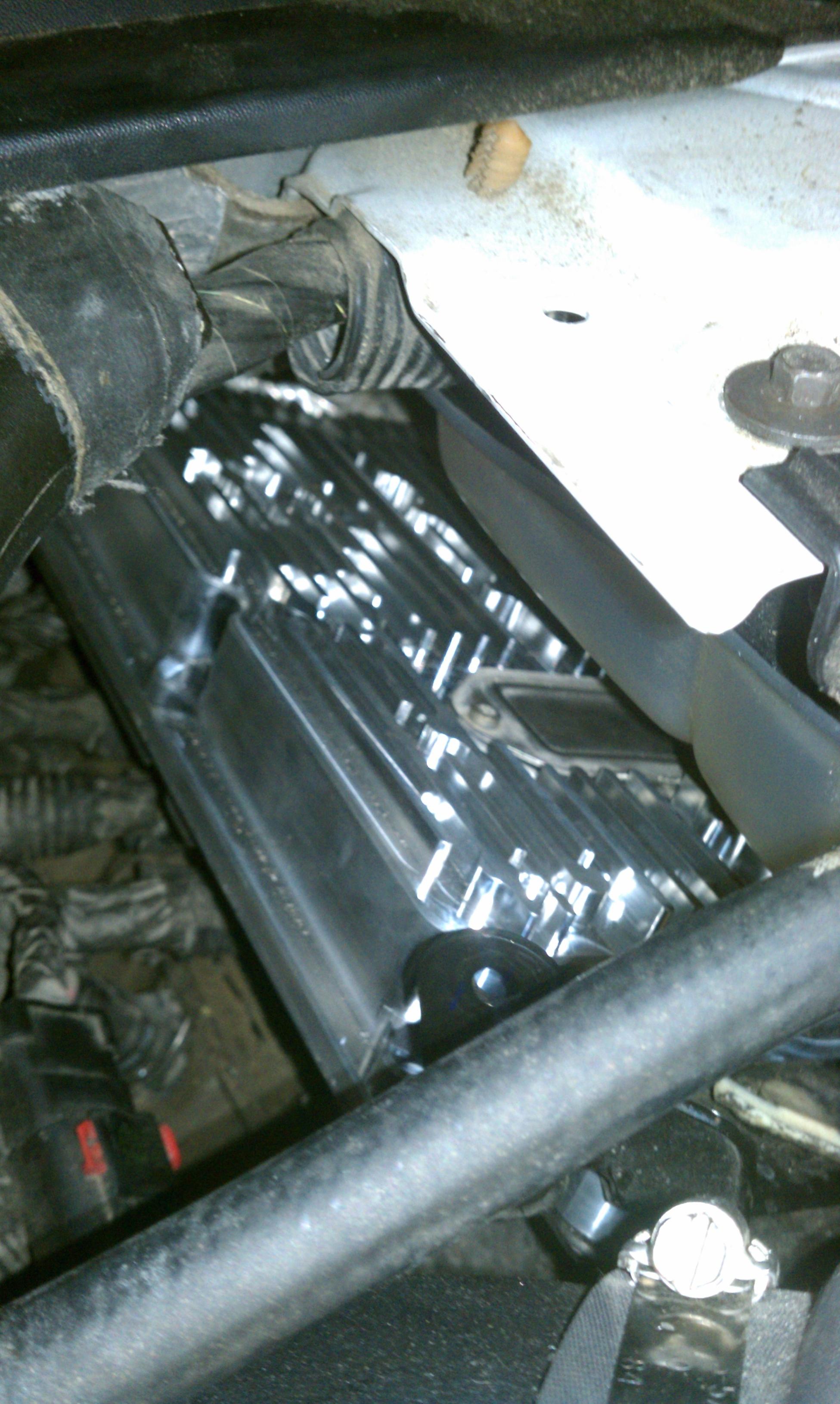

e.nickkk
Jun 18, 2012
525
Just got mine today looks great but how it performs is the story so far didnt run it much but will update everyone after a few days
