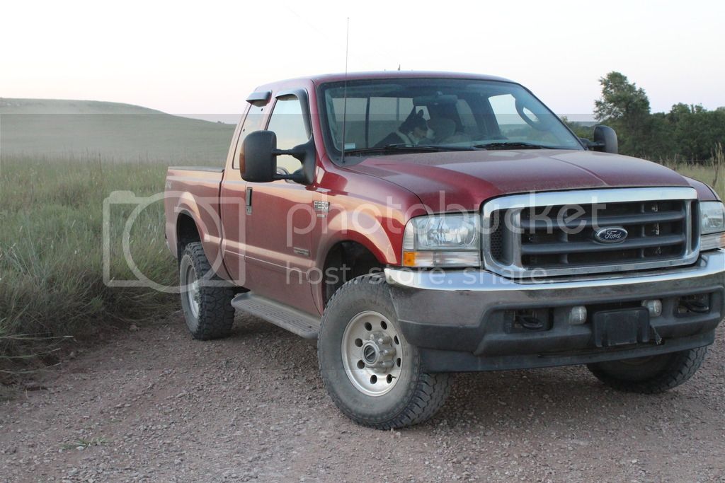

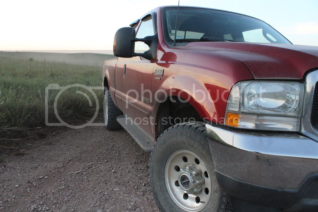

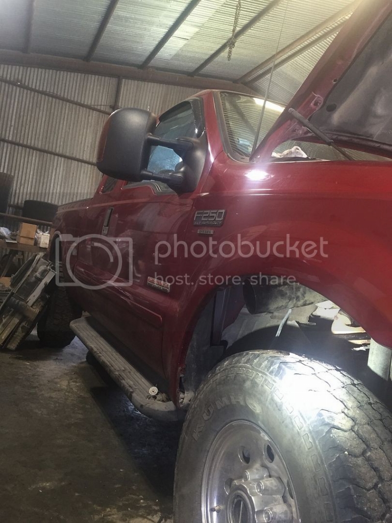

So we have been working on this truck for about a month. Most of the updates have been on social media so you might have noticed it.
Story on the truck is I bought it at an auction dirt cheap. Truck is an 03 ECSB with 130k on it. auction description said "engine issues" turns out 2 of the injectors were torqued wrong and the thing was dumping fuel in the cylinders.
My overall goal with the truck is to cut it up and build in my eyes the ultimate trail/prerunner truck with it but for now its just a track toy. Since Im going to be using it for my prerunner I pulled the motor and trans and swapped in by built motor and trans out of my 06 (the original project prerunner truck). I also installed an RCD thumper 2 pump and built the injectors to 260cc.
